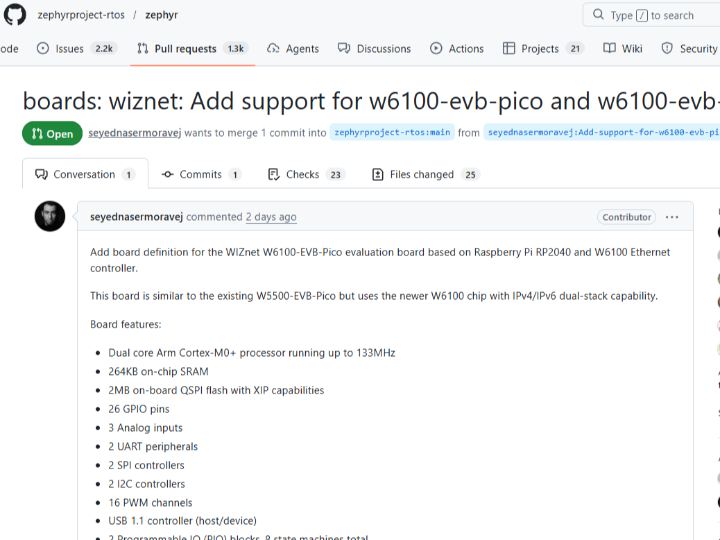

Zephyr PR #104394: Architecture Analysis of W6100-EVB-Pico & Pico2
Zephyr PR #104394 brings W6100-EVB-Pico2 support! It pairs RP2350 with W6100 (IPv6) and enables high-speed 70MHz SPI.

This PR goes beyond simply adding board names; it serves as a significant technical reference demonstrating how the Zephyr Hardware Abstraction Layer (HAL) defines and controls the RP2350 (Pico 2) and W6100.
We have analyzed the key modified files to summarize the core technical details regarding hardware definitions and system configurations.

Community Interest & Next Steps
Although this PR (#104394) was opened very recently, it has already attracted significant attention from the Zephyr community. Notably, 6 reviews have already been posted by key maintainers, signaling strong interest in the official support for the RP2350 and W6100 combination.
This rapid feedback loop suggests that this board support is highly anticipated. We encourage the WIZnet Maker community to check out the PR, test the code if possible, and show your support to help expedite the merge process!

Q3. Can I use this board in Zephyr right now?
  • A: Since PR #104394 is still under review, it is not yet available in the main Zephyr branch. To use it immediately, you must fetch the PR branch manually or wait for it to be merged into the mainline. The active review status suggests it may be integrated soon.
[View PR #104394 on GitHub] https://github.com/zephyrproject-rtos/zephyr/pull/104394https://github.com/zephyrproject-rtos/zephyr/pull/104394
