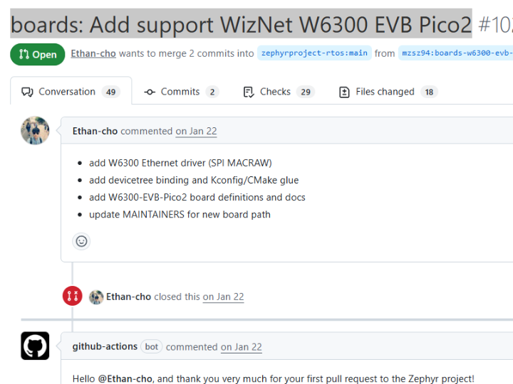

What This PR Does
This is an Ethernet driver PR that enables WIZnet W6300 support on Zephyr RTOS.
It brings the W6300-EVB-Pico2 board (RP2350 + W6300) into the Zephyr ecosystem — adding the driver code, Devicetree binding, board definition files, and documentation all in one go.

Authored by WIZnet engineer Ethan-cho (Manjae Cho), the PR is currently going through community review with the goal of merging into the Zephyr mainline repository.
