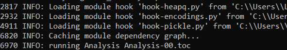

Greetings.

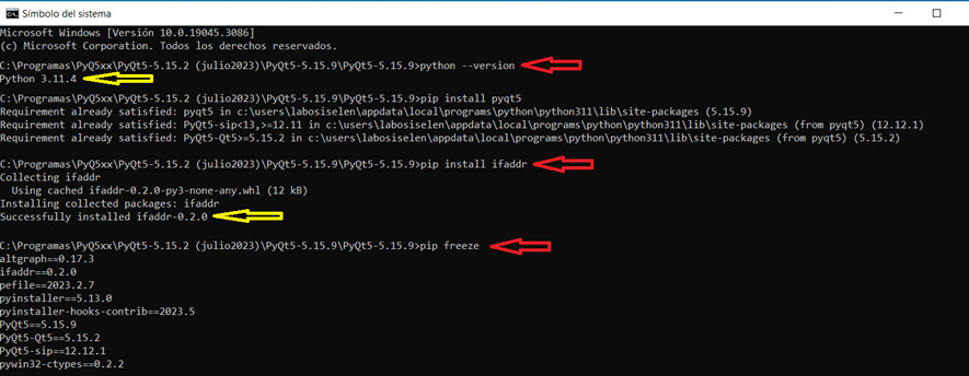

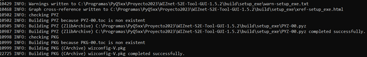

I sent steps carried out and a brief description of the error
it can not be executed
any problem with any version?
Thank you

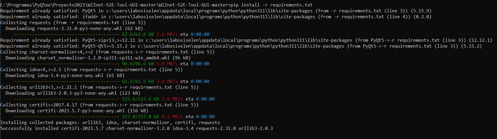

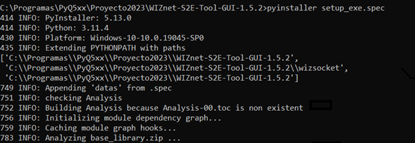

1: C:\Programas\PyQ5xx\PyQt5-5.15.2 (julio2023)\PyQt5-5.15.9\PyQt5-5.15.9>pip install pyqt5
2: C:\Programas\PyQ5xx\PyQt5-5.15.2 (julio2023)\PyQt5-5.15.9\PyQt5-5.15.9>pip install ifaddr
3: C:\Programas\PyQ5xx\PyQt5-5.15.2 (julio2023)\PyQt5-5.15.9\PyQt5-5.15.9>python freeze
etc
etc
etc

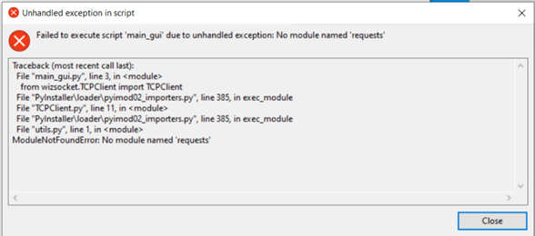

when executing (.exe) it gives this error
RE: WIZnet-S2E-Tool-GUI 1.5.2 COMPILE in win10.
by rena ·
The cause of the problem was the missing requests package, which I put in because it was needed for a feature I was going to add later.
I only updated this in the
developbranch.I’ve merged it into the master branch now, please download it again and test it.

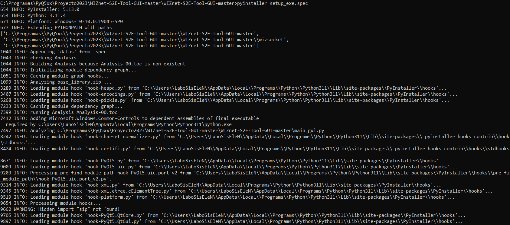

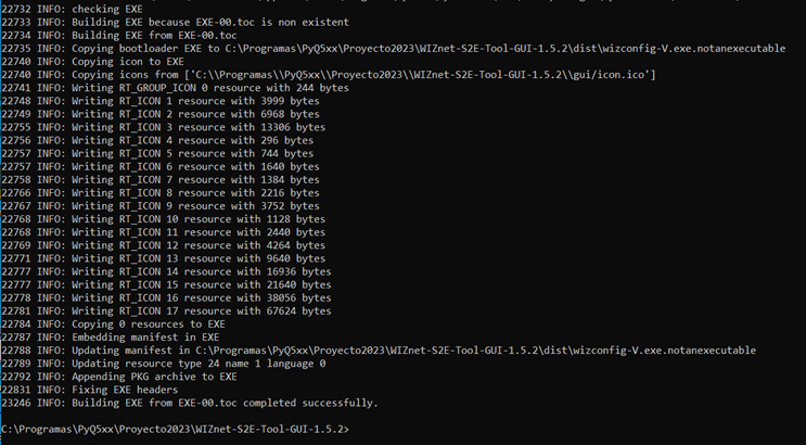

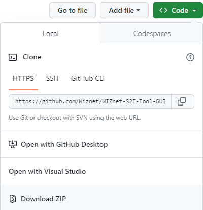

by rena ·
You can download it from the Github master branch.
You can use the
git clone https://github.com/Wiznet/WIZnet-S2E-Tool-GUIcommand, or download the ZIP.When installing the package, recommend using the following command.
by WiznetSis ·

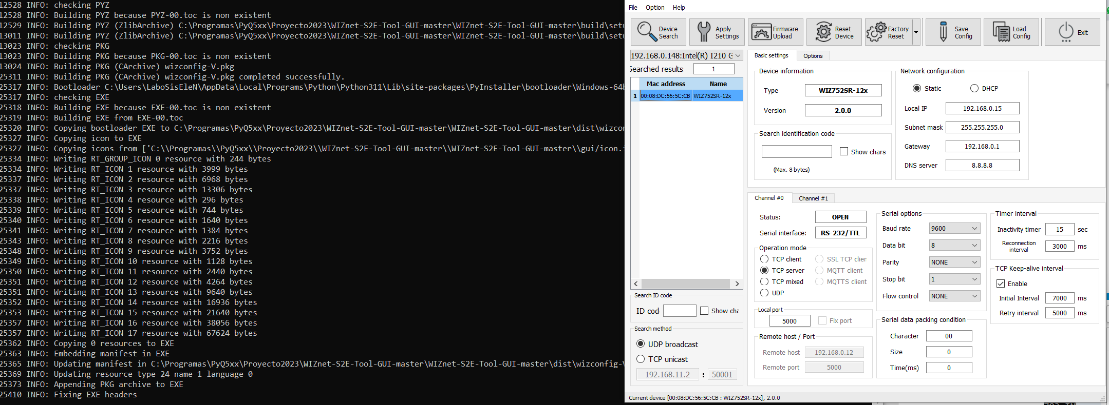

resultados de la prueba
Trials with successful results.
Perfect
Muchas Gracias

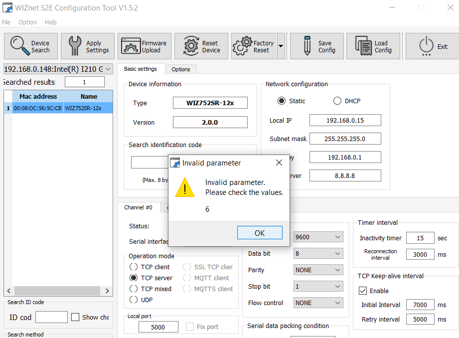

by WiznetSis ·

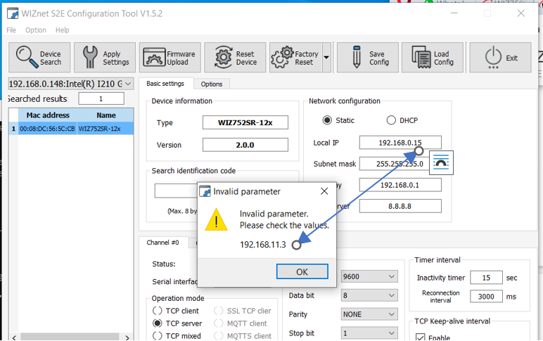

Now functional tests:
-Starts
-read the module without changing any parameters
-I tell him to save
-start typing all these errors and more
-you have to close the whole program

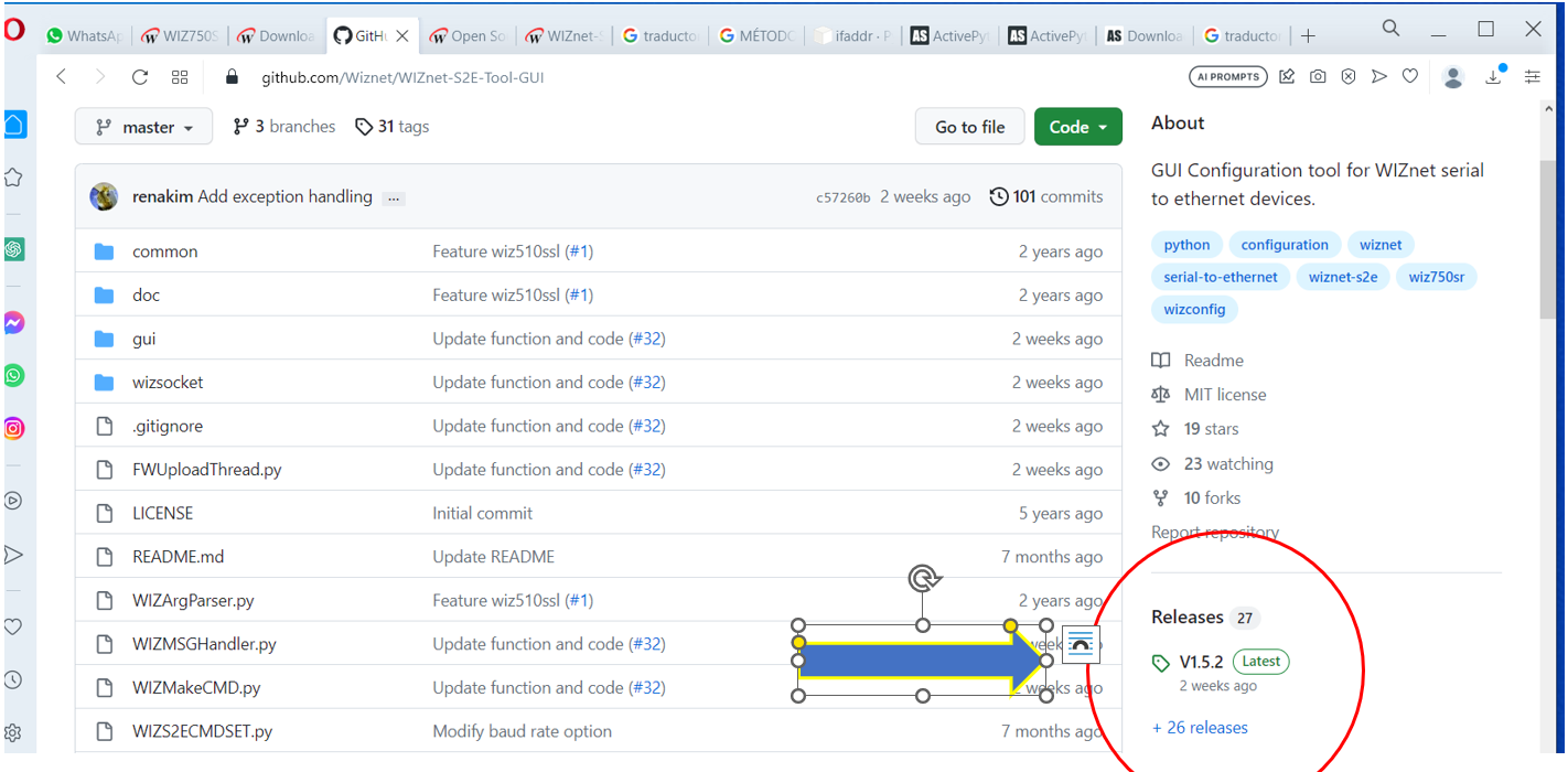

by WiznetSis ·
IMPORTANT INFORMATION:
to verify I went to the repository page
and the version that this does the same
Someone is using version 1.5.2 in WIN 10 and it works fine?
