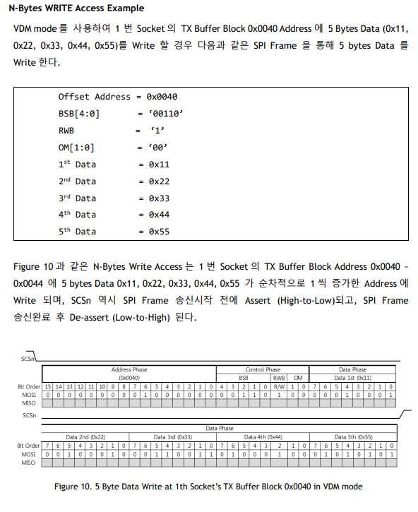

The WIZCHIP_WRITE() function allows the MCU (Master) to control the W5500 (Slave) chip.
For more information, please refer to our datasheet.

thank you. i’ve read the data sheet many times. it does not say whether i need to provide the WIZCHIP_WRITE() function an MCU address or a W5500 address. Furthermore, neither have 32 bit addresses which is what this function is expecting (os atleast it is converting what i give it into an uint32 type)
so in conclusion, do i need to provide this function with an MCU register address, or a W5500 address?

To control the W5500, you must write and read registers in the W5500 internal address area. It is separate from the MCU memory.
