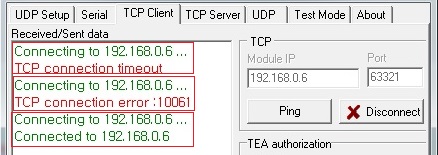

The problems can arise because of HWTRIG pin or Hardware Trigger switch on WIZ107SR-EVB.
Please check the module’s status using configuration tool. [status:OPEN] is correct.
I’ve attached capture of TCP client connection test result.
1st message : module power off - Timeout occurred
2nd message : H/W Trigger on - Socket error #10061
3rd message : H/W Trigger off - Connected [O]
