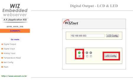

First, if some action in web page occurs, web data is transmitted to MCU in WIZ200WEB board.
So I will take an example about LED config.
If you check first LED box and click the LED Config dialog box, html source code is transmitted to MCU(you can see source code in dout.html)

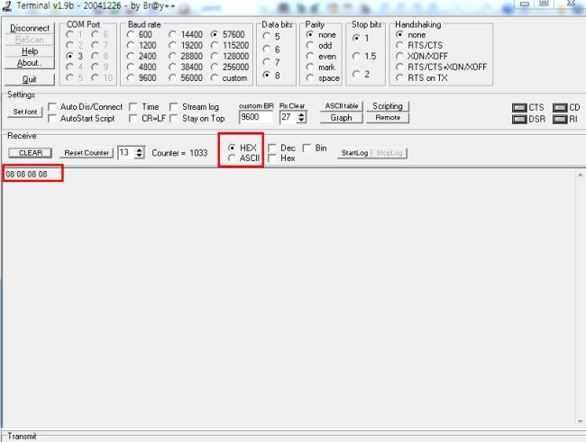

I use uart 0 port for data transfer using uart_putchar().
Then you can see data transfer has done.
