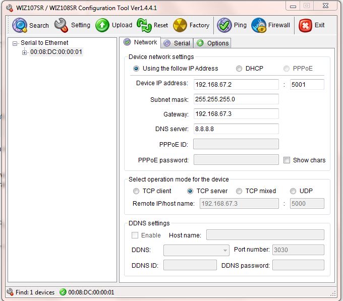

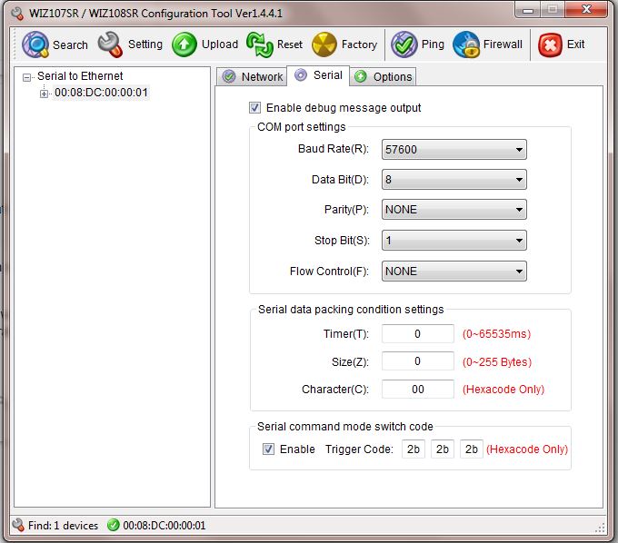

I have 2 Wiz107SR Modules i tried them all with different enviroments ( stand alone local network by switch ) and also directly from PC to the module but nothing worked
it was working before but now i don’t know what is the problem
here the configuration for the network and the serial from configuration tool
