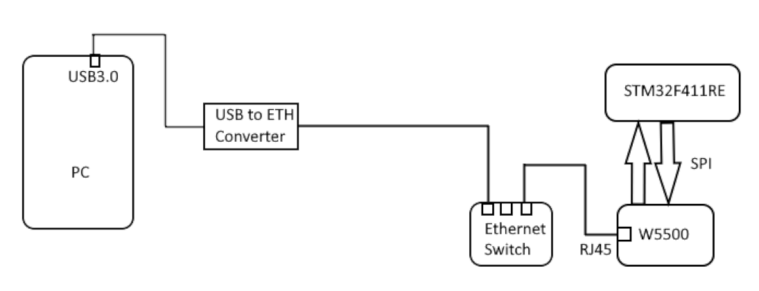

The one on the picture must not be virtual, it is real usb-ethernet adapter.

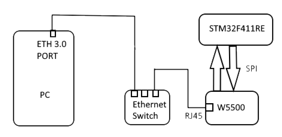

Can the device where you plug the usb side of adapter communicate with the network (apart from W5500)?
RE: RE: W5500 Usb to Ethernet Interface
by TraiLoR ·
The Topology on the upper side is commnucating with no problem but the one below isnt
Thanks

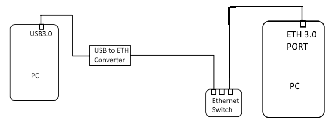

Can this one communicate?

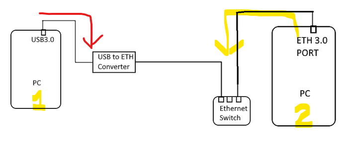

Strangely I can ping the PC2 through red arrow from PC1. But I cant ping PC1 through yellow arrow from PC2.
Thanks
Seems first thing to do is to ensure driver for the dongle is latest version, and then check if there’s any management utility for it where you can view and change settings.
