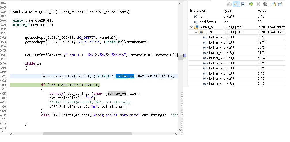

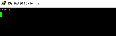

After open the connection i try to send to W5500 the following string
The W5500 get correctly the data and send it to the UART
The execution continue looping to the previous blocking instruction, and i think the problem is here.

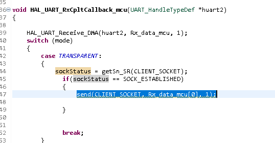

Now if i write data to the UART by opening a serial terminal, i have that the instruction
assign to sockStatus values that can be “0”, “72” and “23”.
In case the instruction
is executed from the uart rx routine handler, the recv instructions becomes unlocked and return always a not zero length.
