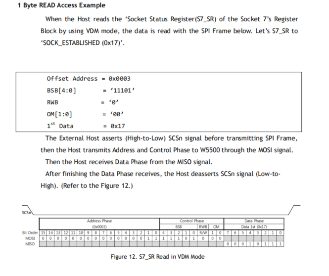

Hi Eugeny
Thank you very much for your answer.This is because the W5500 communicates with the MCU through SPI. I’m looking at the data book and the examples on github. The Offset Address here is to send 8bits data twice via SPI. The later Control Phase and Data Phase are also 8-bit.I was wondering if SPI could be configured to send 16 bits of data at a time. Then Control Phase data I only select the higher eight digits to send. The following Data Phase data. I send 16bit data at a time.
RE: About the W5500 Ethernet chip, sending and receiving data bits
What problem are you trying to solve or what are you trying to improve? SPI transmits one bit a time, not one byte or one character a time, and it does not matter if you feed the intermediate circuit with 8-bit data or 16-bit data - at the end they all are converted to bits.

I think I’ve got an idea. I’ll give it a try. Thank you very much for your patient answer.
