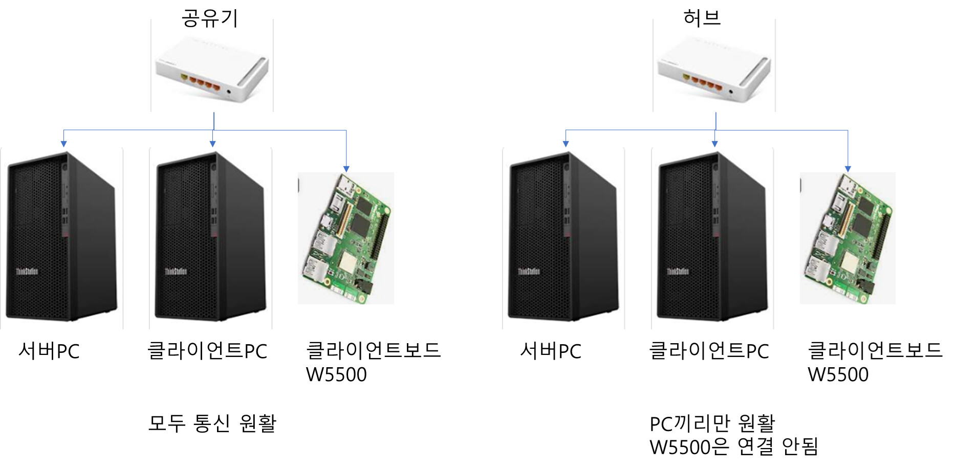

스위칭허브와 W5500 연결
RE: 스위칭허브와 W5500 연결
by mirr9351 ·
이미지로 표현하면 이런형태입니다.
RE: 스위칭허브와 W5500 연결
W5500 must obtain IP address using DHCP first, or you should hardcode/somehow configure valid IP address into the chip (each chip on the network should have unique IP address, as well as MAC address).
RE: RE: 스위칭허브와 W5500 연결
by mirr9351 ·
DCHP로 구동되고 있습니다.
공유기에 물려 있을때는 IP가 할당이 되는데, 스위칭 허브에서는 할당이 안되네요
이유를 모르겠습니다
RE: 스위칭허브와 W5500 연결
Ok, this is different story. In this situation, even if router does not display the device host name (provided through option 12) it must show the IP address assigned to the device. If it does not, then something is misconfigured, and router blocks the messaging. First of all, check MAC address you have chosen for the W5500 to be valid.
