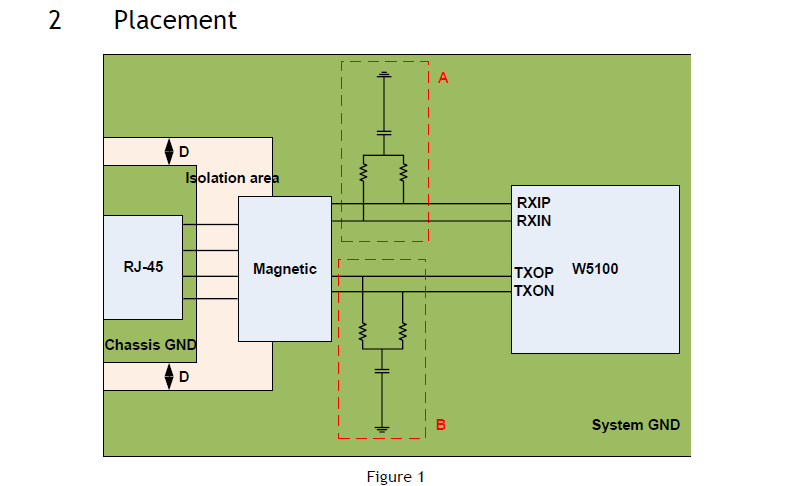

I hadn’t seen that layout guide before. However, I did use the reference schematic, I was just seeing if I made any obvious mistakes in comparison.
The layout guide seems to match what I have done by the looks of it? Mayveb the only thing is to change the signals going to the magnet. Mine are around 16mm from the magnetic component to teh resistor/cap combo. Is this sufficient to satisfy the following:
