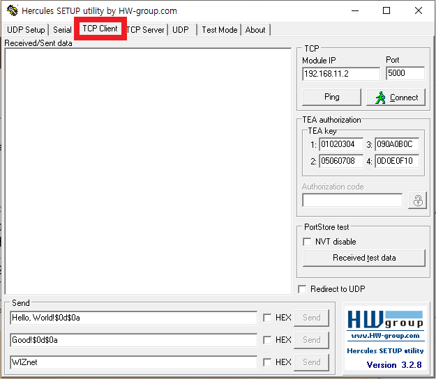

Next thing will be to figure out how to debug my creation. To be able to see anything on my server inside the W5500-evb-pico card… Any easy suggestions?
RE: A new example of compiling with CMake (w5500-evb-pico) without Visual studio (C lang)
Hi @Gruber
If you created the server normally,
Next, you can easily check whether the server is workiing normally by using a tool called Hercules as a client.
