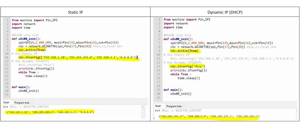

I used the firmware 2.0 again and this time the led is working when I added “nic.active(True)” and I’m using a static address (same as in firmware 1.5) but I can’t ping the IP-address…

Sorry for not reading your example in the right order and thanks for the solution with firmware 2.0!
For other readers you have to activate the network interface before you set the DHCP or a static IP-address/subnet mask/gateway/DNS.
Example:
Tested ping example with a static IP:
