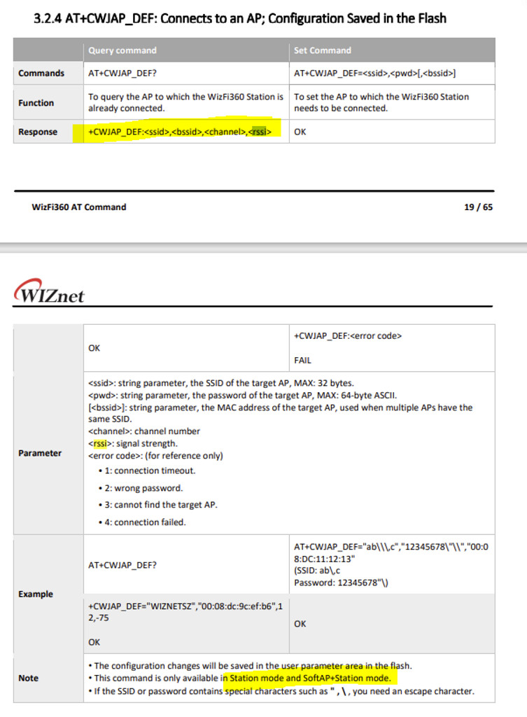

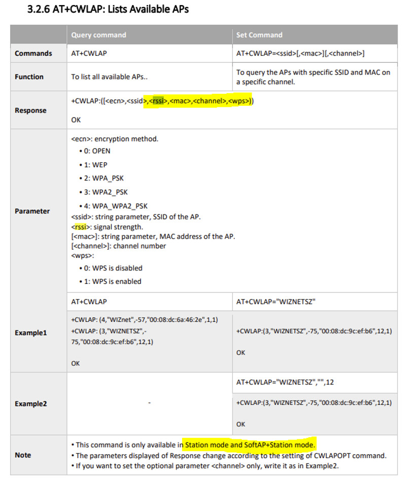

RE: RE: Get RSSI when WizFi 360 Module is configured as SoftAP mode
by Padmini ·
Hi Scarlet,
Thanks for response and i have a query on the response given.
The query is:
There are commands which gives RSSI value, but WizFi module should be configured as Station Mode or SoftAP+Station Mode. Please check the below commands.
So, I am wondering how come above commands respond with RSSI if
RSSI functionality is not provided by the Wi-Fi chip manufacturer
Thanks,
Padmini
by scarlet ·
Dear @Padmini
About your question,
This is because the manufacturer’s library are provides RSSI’s station, AP+station mode only.
I checked the manufacturer’s document for an answer.
And it is confirmed that RSSI for AP mode is not provided.
I’m sorry I couldn’t provide you with the features you need.

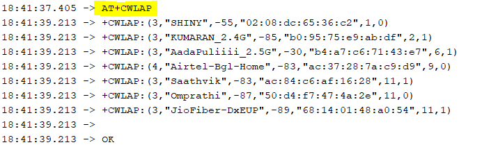

by Padmini ·
Hi Scarlet,
I have a question regarding Station + Access Point Mode, Below are the details:
We have configured WizFi 360 module in Station + Access Point Mode, and done the necessary configurations as below
AT+CWMODE_DEF=3
AT+CWDHCP_DEF=0,1
AT+CWSAP_DEF=“StationAndAP”,“Option1Test”,1,3,4,0
AT+CIPAP_DEF=“192.168.52.1”,“192.168.52.1”,“255.255.255.0”
AT+CWDHCPS_DEF=1,120,“192.168.52.100”,“192.168.52.200”
AT+CIPMODE=0
AT+CIPMUX=1
AT+CIPSERVER=1,8888
Now, when I use command AT+CWLAP, it lists all available AP’s except it’s own i.e SSID: StationAndAP.
But I can see that SSID (StationAndAP) on my system and able to connect to that SSID which means that Access point is correctly configured and advertising.
So, My question is: Does the command AT+CWLAP identify it’s own Access point details when the device is configured in Station + Access point mode??
Using any commands, is it possible to get the details of own access Point (RSSI) when the device is configured in Station + Access point mode??
And when we actually use Station + Access point mode ??
Thanks,
Padmini

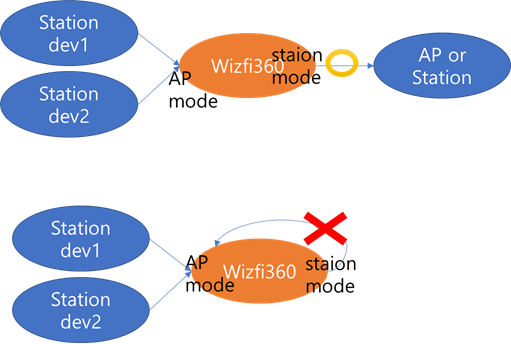

by scarlet ·
Dear @Padmini
about your question,
It seems that, Wizfi360 obtain AP information (including RSSI) from AP after register itself as an AP.
It’s not surported.
The station does not get it’s own AP information.
The AP+station has functions as an AP for devices in the local area, and is also connect to ‘other’ device as station client.
