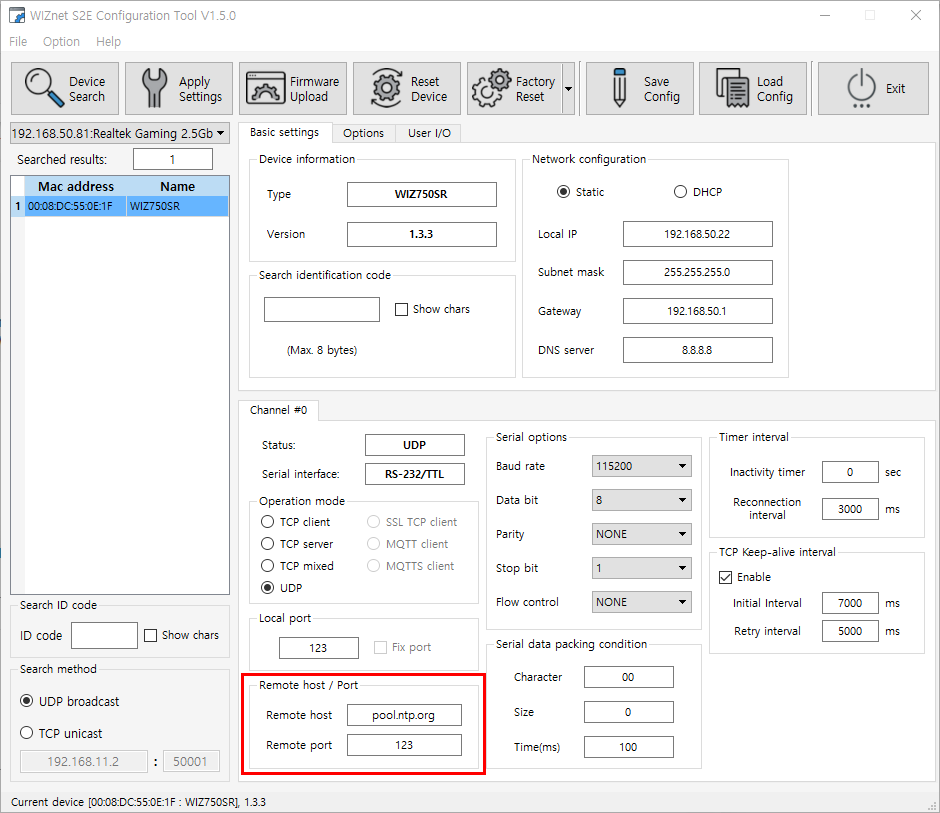

Hi @SerZTF,
You can use Socket communication to receive data from an NTP server. It is the same as the method of WIZ550S2E.
After setting the device using the Configuration tool, you can receive a response from the NTP server by sending data in a specific format via serial.
Set the NTP server as the hostname. below is the reference snapshot.
You can send and receive information with WIZ750SR standard F/W, but if you need a function to apply the received information (like syncronize), you need to modify the firmware.
The firmware is open source and runs in the Keil V5 environment.
