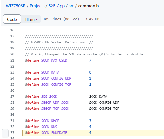

It is a big thank if anyone can instruct how to change the socket function in the firmware: reducing the sockets used for UDP and incresing the one used for TCP clients GitHub - Wiznet/WIZ750SR: WIZnet Serial to Ethernet(S2E) module based on W7500 chip, WIZ107/108SR S2E compatible device

Currently, WIZ750SR support only 7 sockets and you can use 5,6 as you want.
Other socket already defined as config function. (socket 0 is data socket)
main socket function is in seg.c
you can refer the do_seg() to make your own socket.
If you want 1 more socket, you can control socket memory size as 2KB for socket 0 in main.c,
then you can open socket 5,6,7

This is opensource. You can make your own application based on this code.
you can refer the function, void proc_SEG_tcp_client(uint8_t sock) in seg.c
