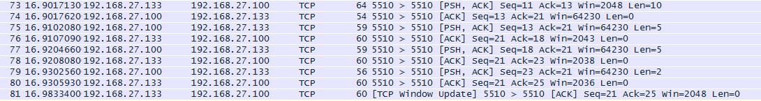

Hi! I use ioLibrary.
RE: W5500, send() fragments packets

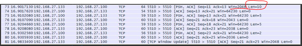

I looked at the capture file you sent me one more time, and I could see that W5500 (ip 192.168.27.133) sent 10 bytes.
You should check whether the server received data by dividing it.
Again, the W5500 sent 10 bytes in one packet.
by tonyk ·
Yyyyyes! Thank you very mach, Irina! I have found a mistake in my programm. The mistake was fixed and the programm work corectly.
