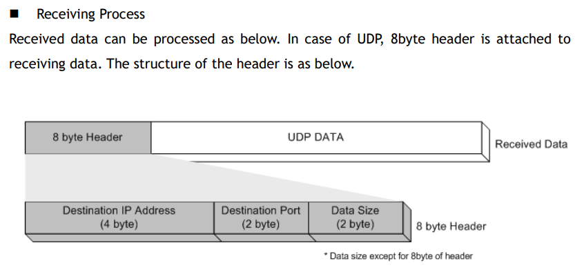

w5500 UDP server. Updating sender information for incoming packets
RE: w5500 UDP server. Updating sender information for incoming packets
This should not happen, each data chunk including its header must provide valid information. Maybe you read this data from wrong location?
RE: RE: w5500 UDP server. Updating sender information for incoming packets
by spontomdela ·
Thank you, Eugeny, you suggested a solution. I checked my code again and found an error there. Using a circular receive buffer, I did not take care of the increment in the function that takes the address. I’m ashamed. I’ll rewrite the code soon and most likely everything will work.
