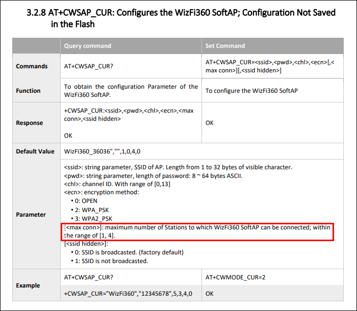

When using WizFi360 as SoftAP, up to 4 stations can be connected.

It seems like the module WizFi630S can support more than six devices (Soft-AP) when it is configured in Gateway mode. Please let me know your thoughts about it.

Hi Austin,
Thanks for the response, we need soft-AP support for about six devices or more, is any other device in your WIFI module product line can do this? Please let me know.
Thanks,
Naga.
RE: WizFi360 SoftAP Max devices
Hi Naga,
More than 6 can be supported.
However, since the number of supported stations varies depending on the memory status of WizFi630S, please test it after implementing the application.
And please note that it is not recommended to connect a lot of stations(more than 10…).
