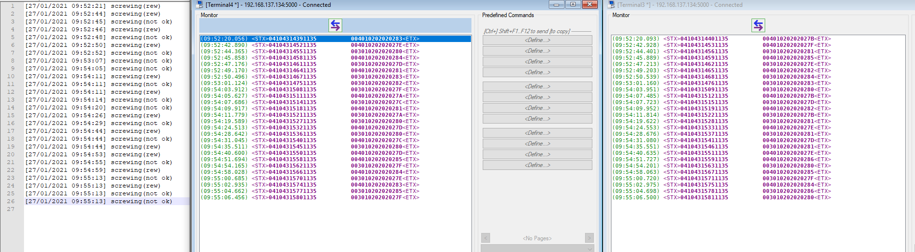

I have asked for some logs from one of the devices which has the messages delayed more frequently, and they sent me a log from one session of testing while connected to 2 terminals and one Tablet.
TCP link ID was: 0 - Terminal1; 1 - Tablet; 2 - Terminal2; and the messages were sent in this order too.
The left Terminal is Terminal1 while the right Terminal is Terminal2, the log file is from the Tablet’s program when it gets the messages.
As you can see, the Tablet gets the messages delayed compared to the terminals on the Network where the server is found.
(Like on line 10, where the message which was sent at 9:54:05 was delayed and so is the two messages after that and they arrived at the same time at 9:54:11)
I hope this helps figuring out the problem, if you need more logs just tell me.

Unfortunately based on your screenshot it is impossible to understand which commands were given to WizFi360. That’s why I asked log from UART1 of WizFi360. If possible, please provide me one, so that I would be able to reproduce your setup exactly and find out the reason.
