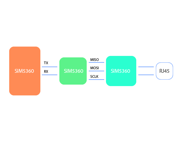

by Semicon ·
Do you need such a scheme?
RE: Internet connection via sim5360e module
Where are the MCU, W5500 in this schematic?
Could you please check whether or not to occur the SIM5360 and Ethernet pin collision?
