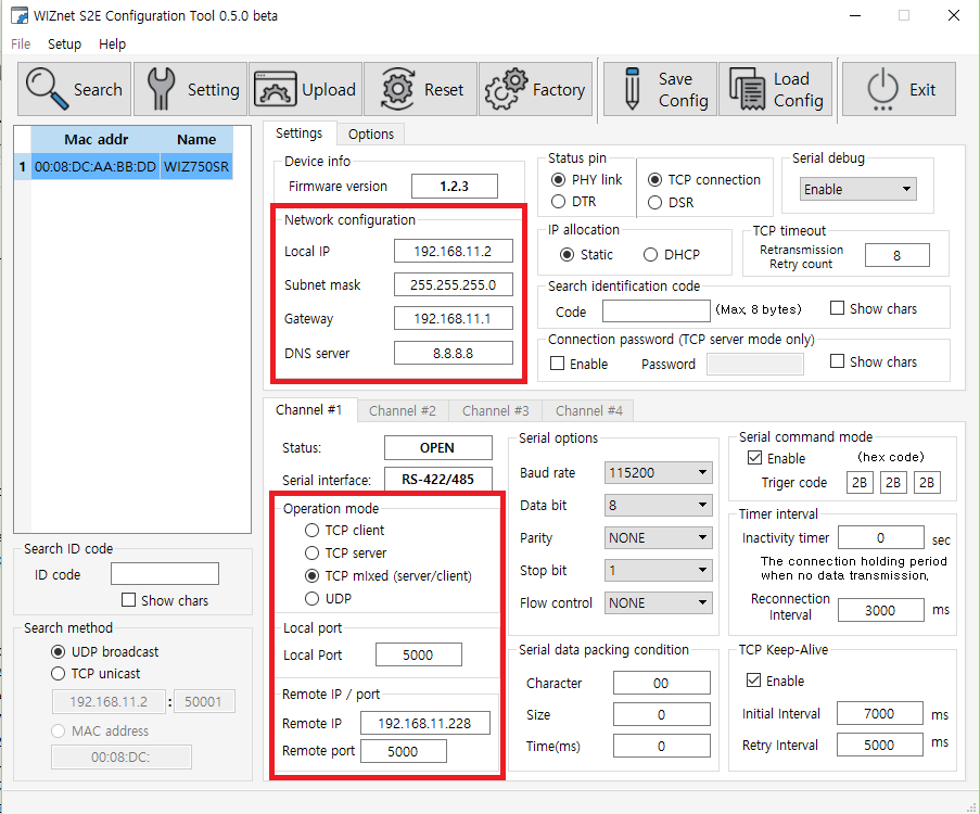

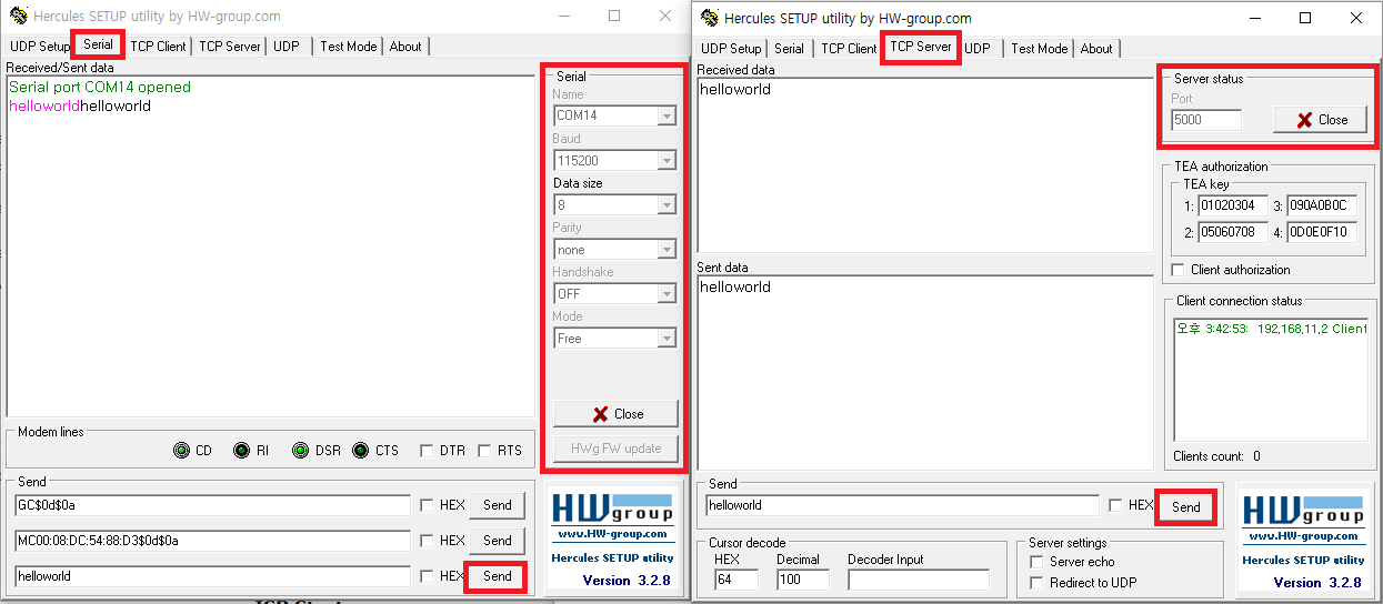

TCP Client test way is refer to below list.
Execute configuration tool and push to “search icon”.
Set to network and operation mode. (TCP Client)
After set done, push to “Setting icon” on the configuration tool.
Search again on configuration tool.
Execute hercules program. (PC set TCP Server)
Set TCP server tap and set IP and port.
Click to listen button
If you connect to serial cable, you can do TCP tests. (refer to below image)

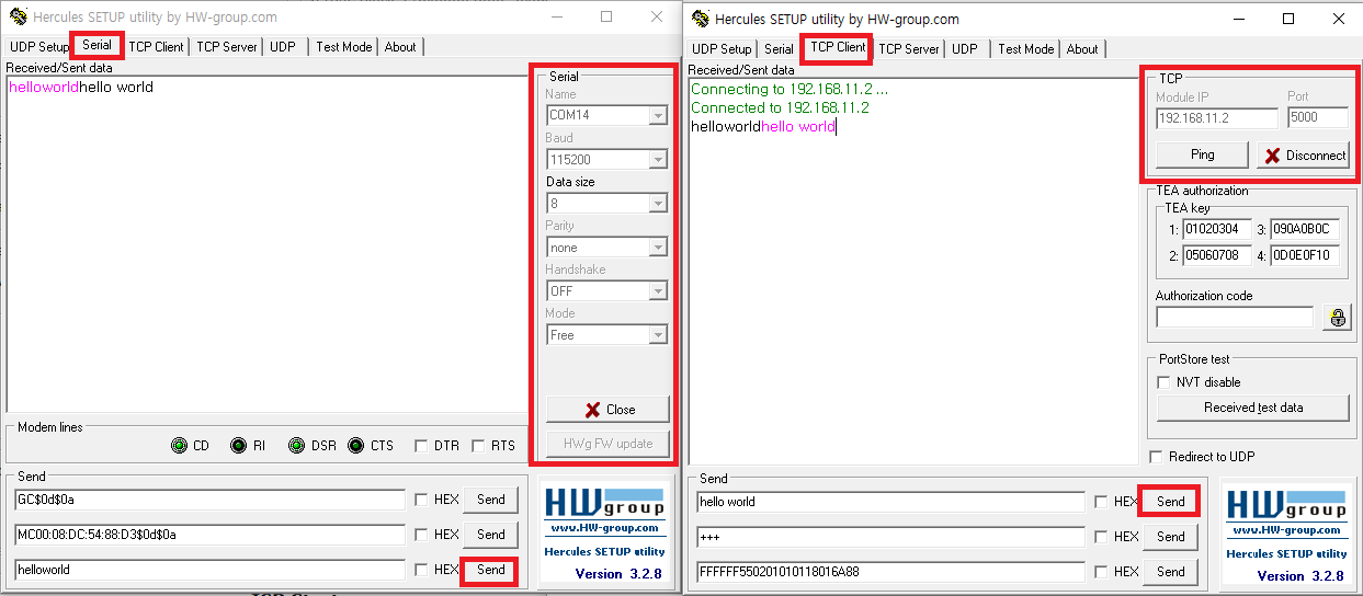

TCP Mixed test way is refer to below list.
Set to network and operation mode. (TCP Mixed)
Execute hercules program. (PC set TCP Server/Client)
Set to users want tap and set IP and port.

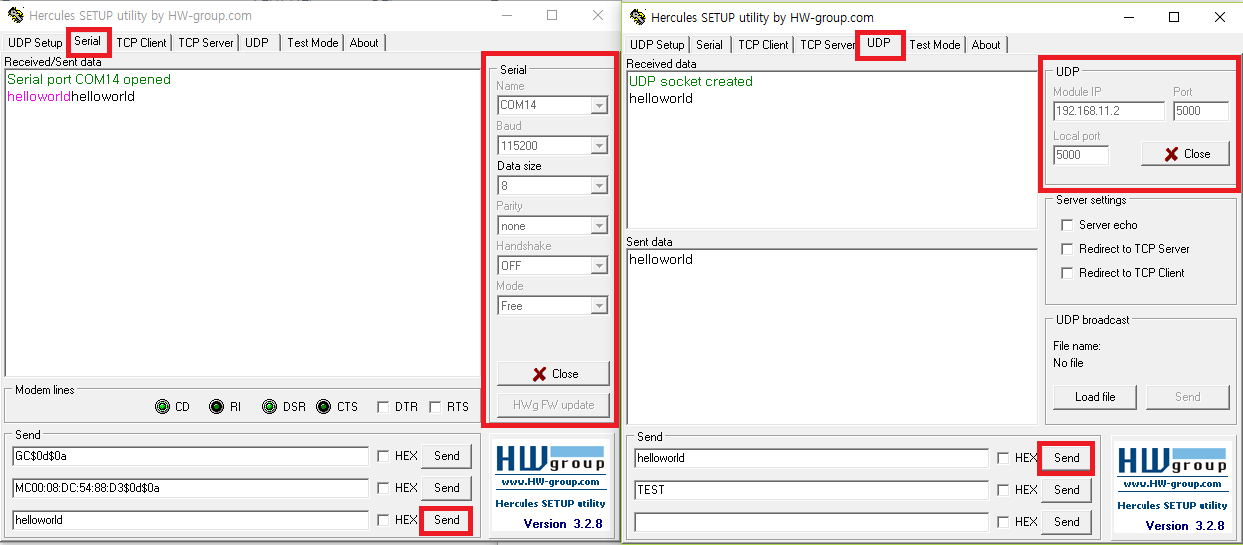

RE: [Modules] How to testing TCP connections?
by Edward ·
UDP test way is refer to below list.
Set to network and operation mode. (UDP)
Execute hercules program. (PC set UDP)
Click to listen
