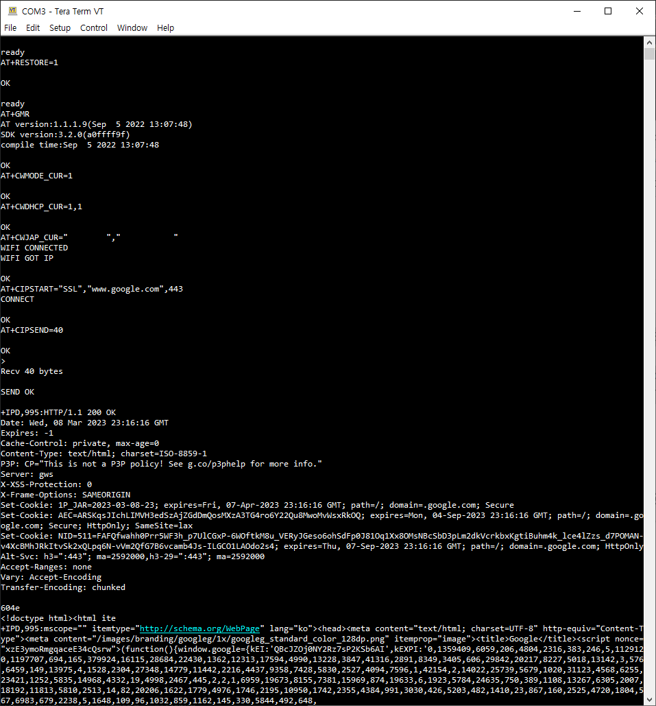

I have tried using ‘AT+CIPSEND’ and it is working as expected for HTTP GET request.

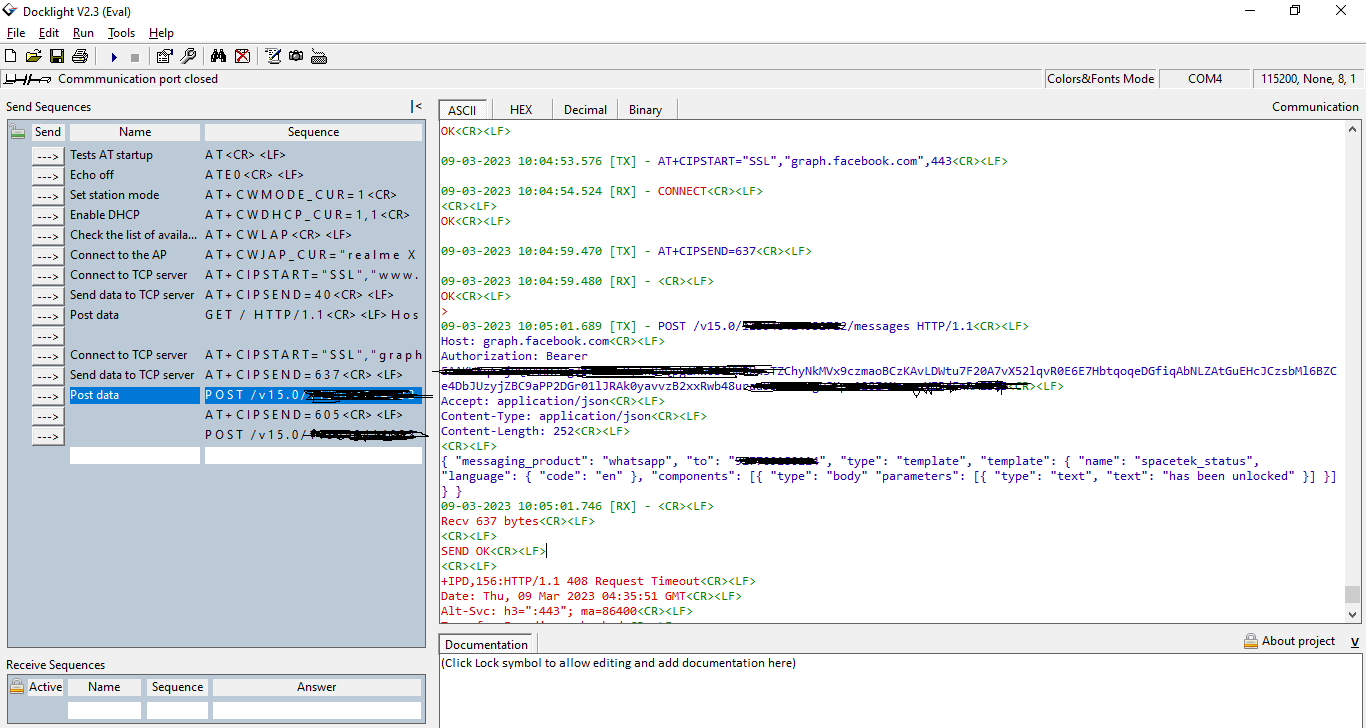

Now, I am trying HTTP POST request.
I need to connect to graph.facebook.com with https. Then using whatsapp api, need to send message.
Following is the sequence
But getting 408 in response.
Can you please give an example of HTTP POST?

I checked using Postman utility. It is working as expected.
Compared data. Content-Length parameter found to be wrong.
Corrected it. Now I am able to hit whatsapp api using WizFi360 also.
