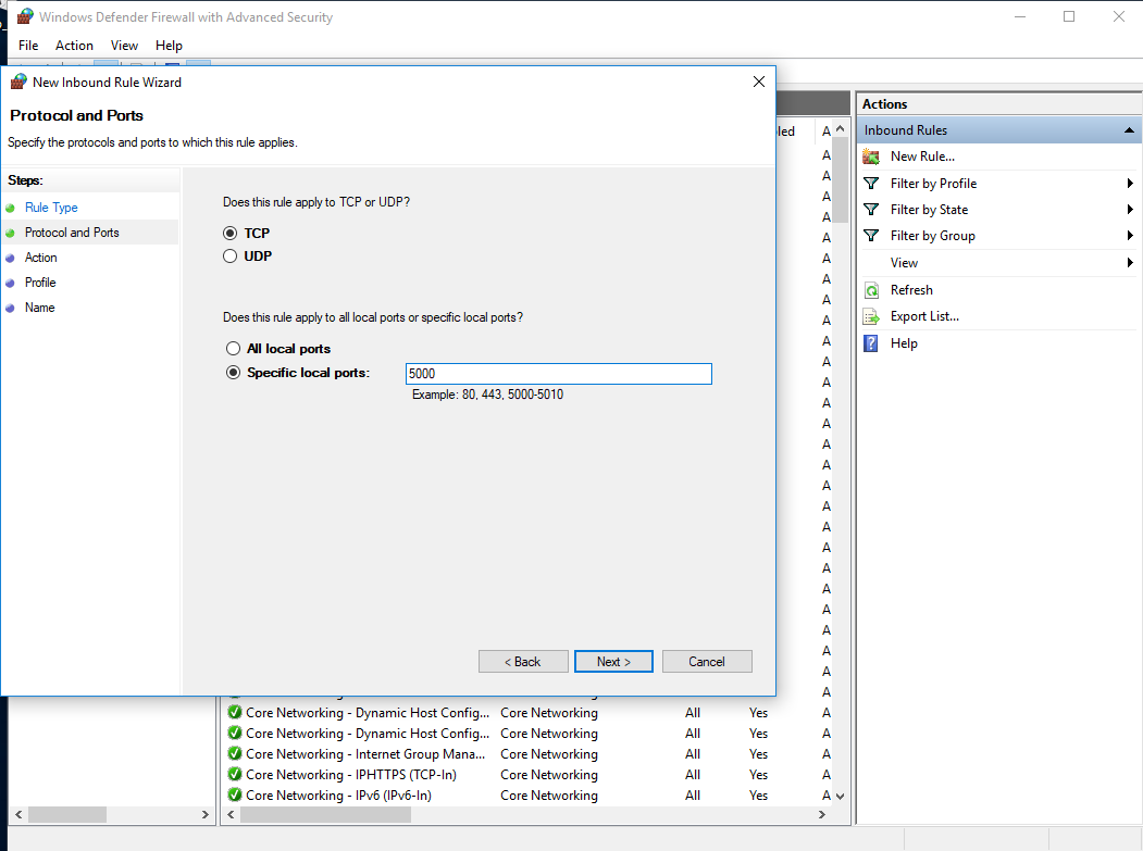

RE: Transfer Data Between Wiz750SR-TTL and VSP
by rena ·
Hello, @neo,
Then, you can set inbound & outbound rules in Windows Defender Firewall.
In the Firewall Advanced settings, set the rule type to port and enter the TCP port to use.
(Range also possible)
RE: RE: Transfer Data Between Wiz750SR-TTL and VSP
by neo ·
Thank you!
It certainly helped me fix the problem!
