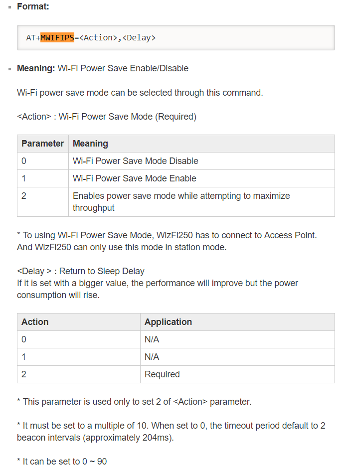

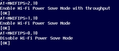

This mean if no AT+MWIFIPS command entered in station mode then power save is disabled?
Enabled only at first AT+MWIFIPS=2 command?
What is the recomneded sequence to change region?

→ Yes, disabled is default. It works AT+MWIFIPS =0, AT+MWIFIPS =1, AT+MWIFIPS =2 also.
