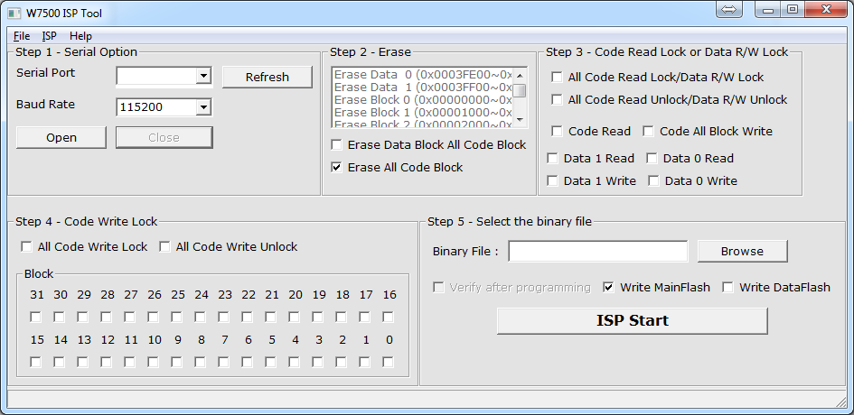

If the configuration data (such as MAC address) is empty after WIZ750SR product production or firmware update using WIZISP, the product asks the user to input MAC address.
You can enter the MAC address in the serial port for ISP in the following format.
For Example,
Please enter the MAC address of your device.
And I attach the MAC address input tool(for using our product production) together. If you have trouble with entering serial data, please use the tool I attached.
WizMACTool_v20151127.zip (7.1 MB)
p.s
When using WIZISP, please select [Erase All Code Block] of ‘Step 2 Erase’. This is because the configuration data of WIZ750SR is stored in the data flash area of the W7500P chip.

thanks for the info,
After that we got some boot data in UART console, but there is no detection of module in configuration tool?
