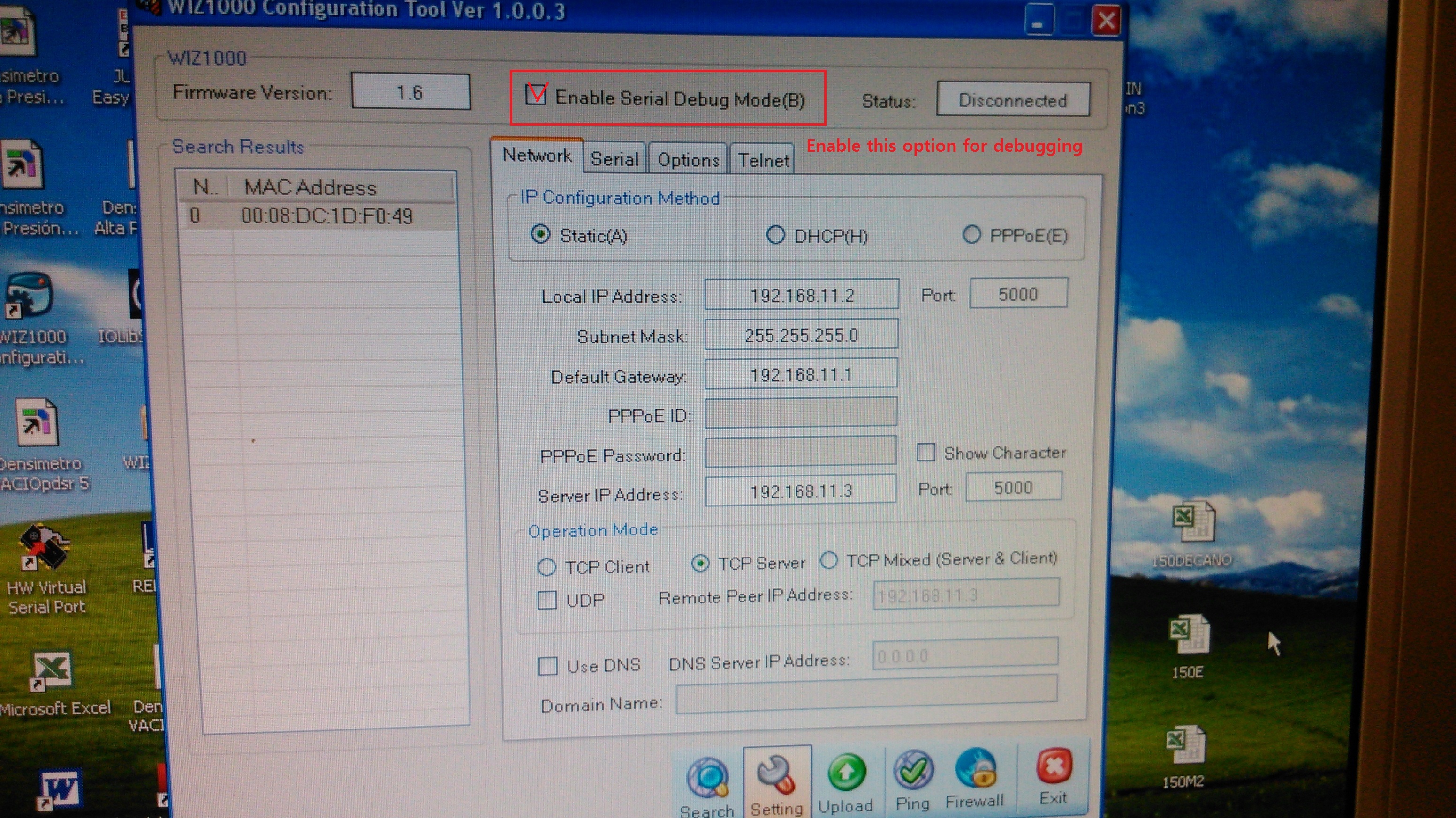

Dear rperez2078
I need more information in detail.
Please test again after enable Serial Debug Mode(B) in cfg tool.
And send all screen images of cfg tool to me. (Network, Serial, Options)

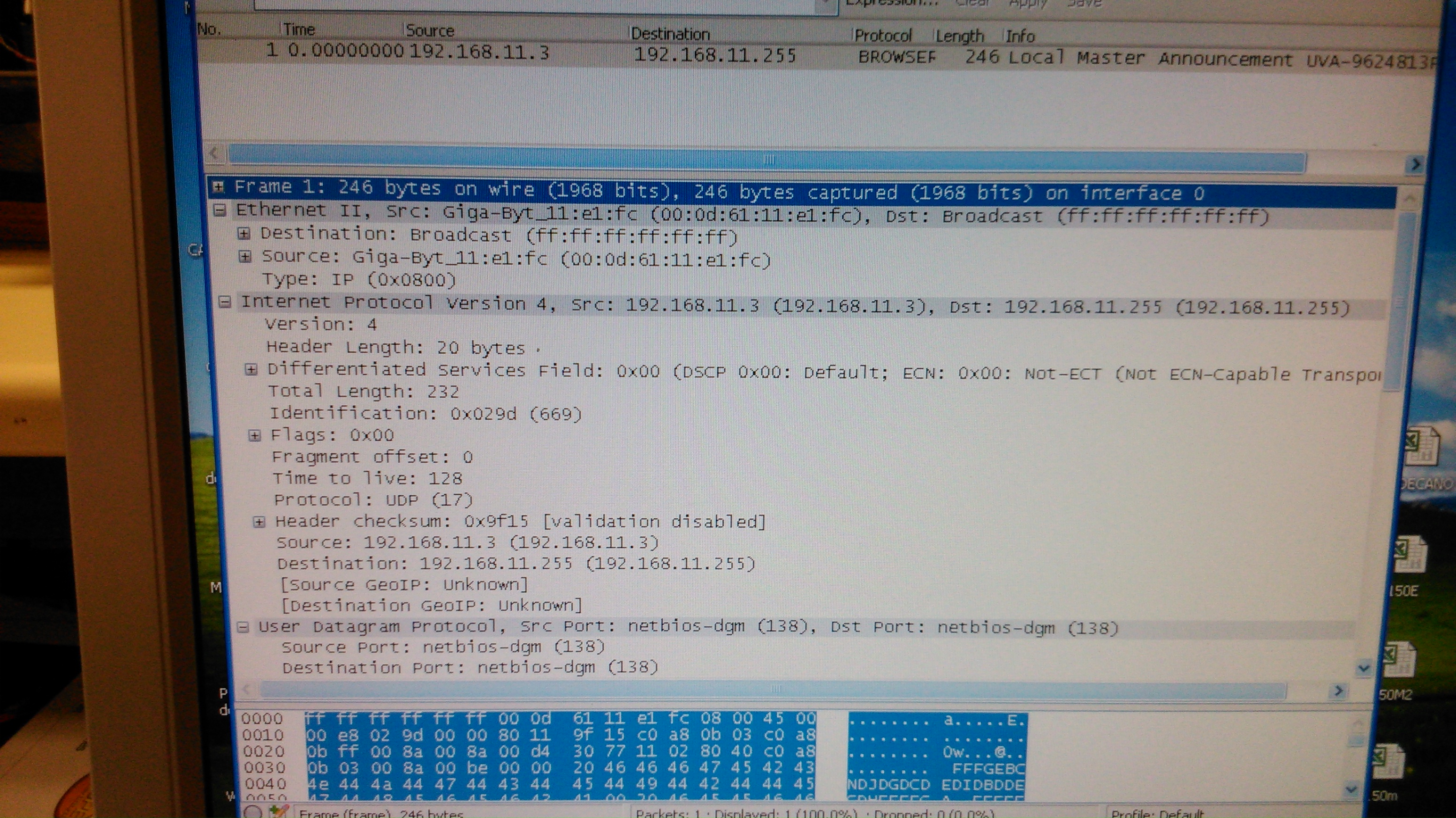

If you can use Wireshark, that log is helpful to me.

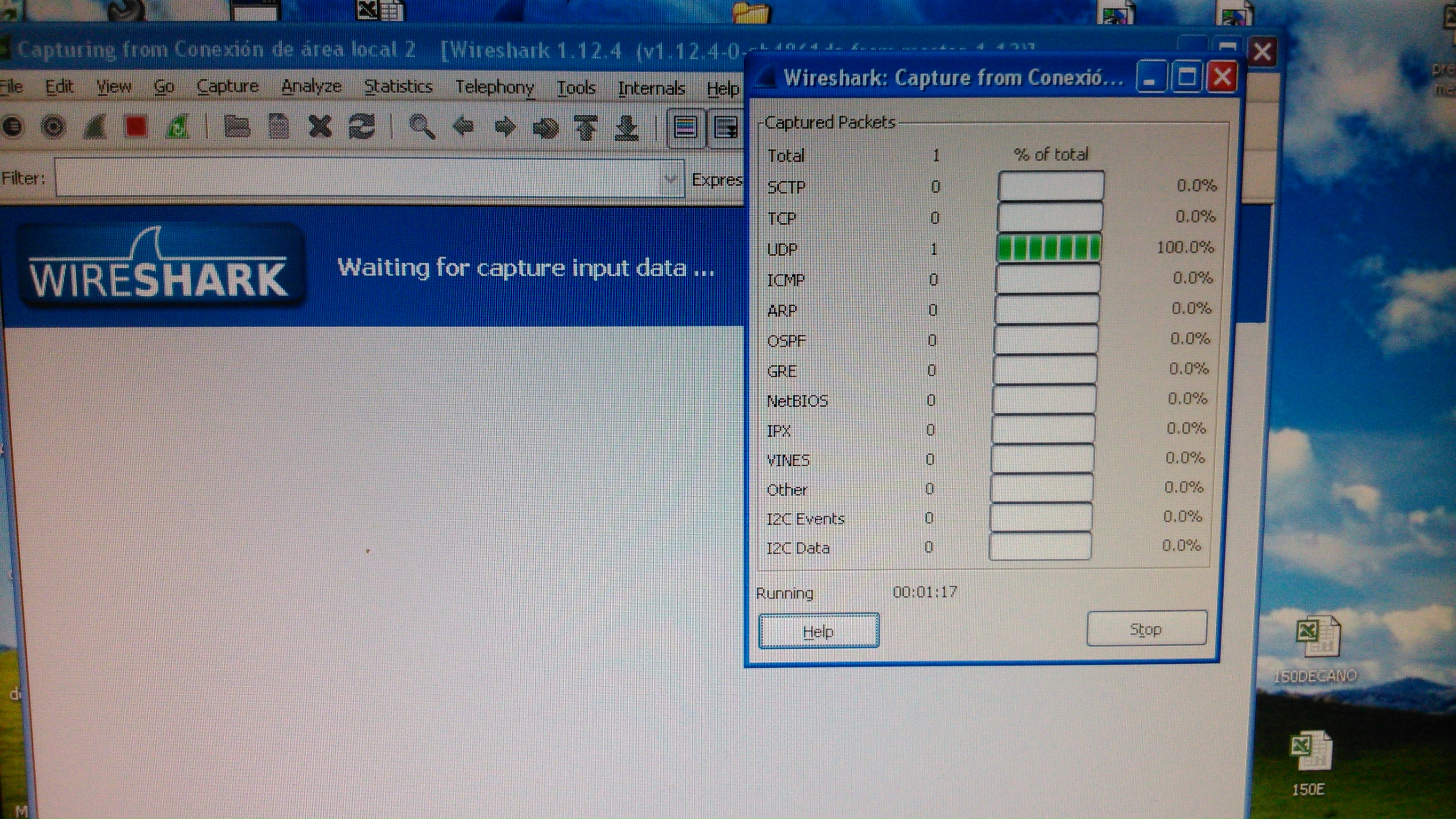

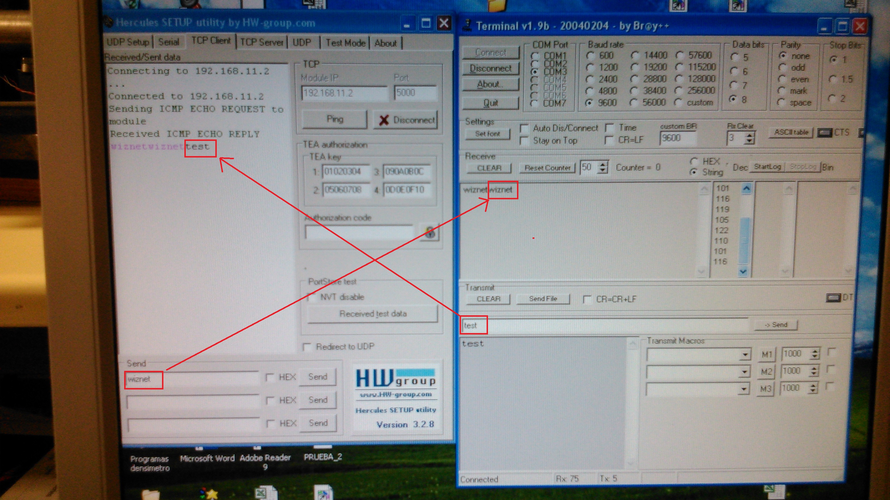

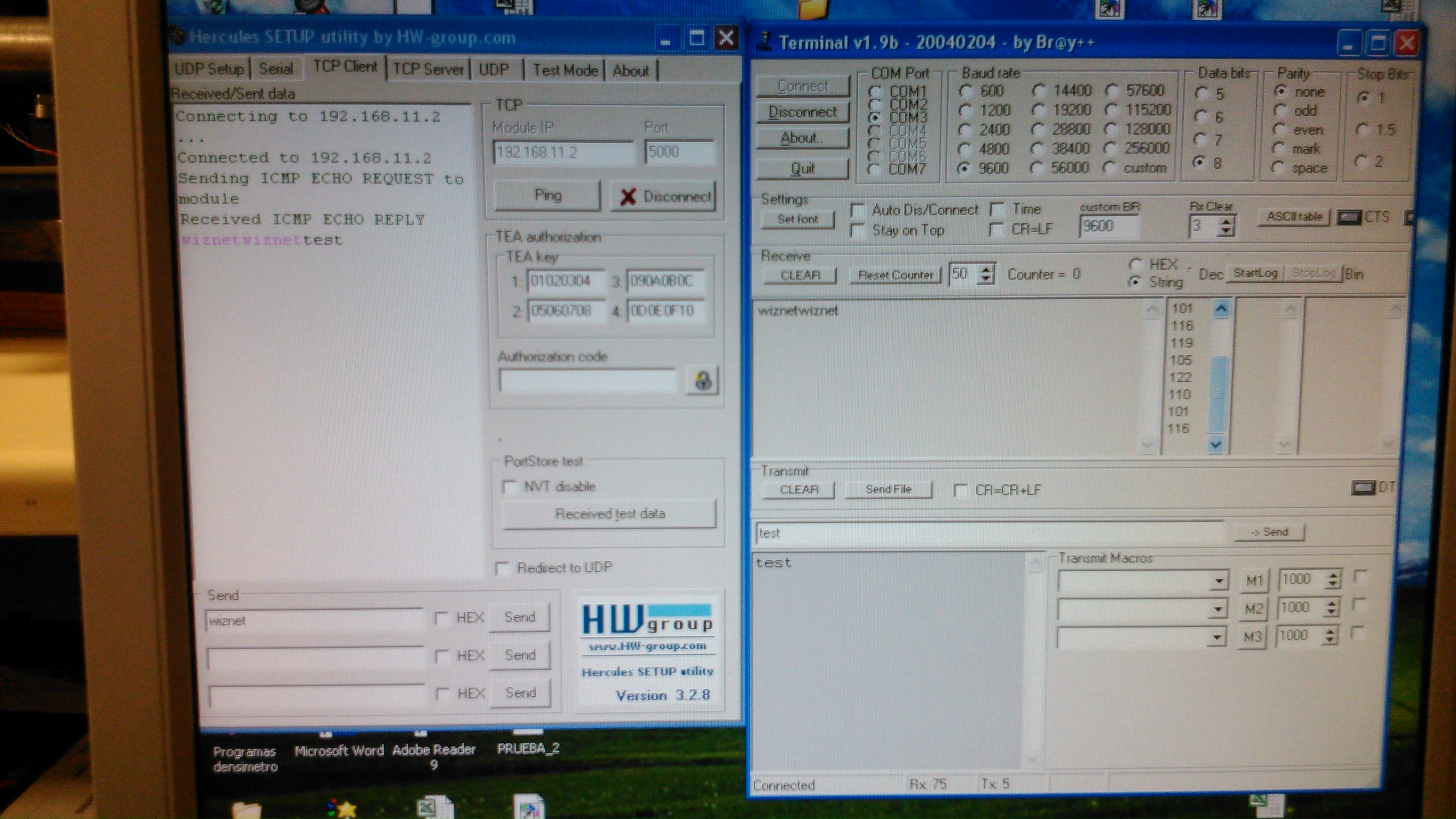

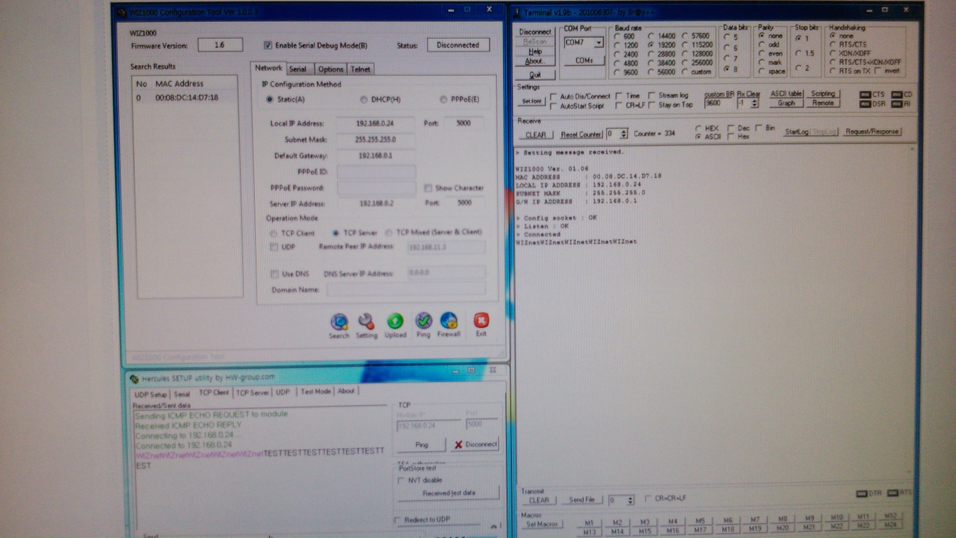

Use the programs you recommended I sent the pictures but when I try to read the instrument nothing appears

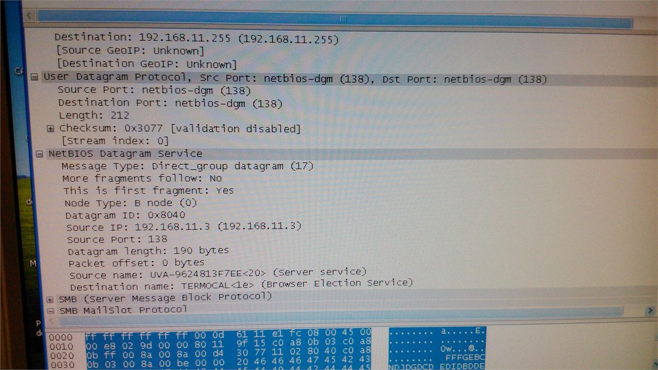

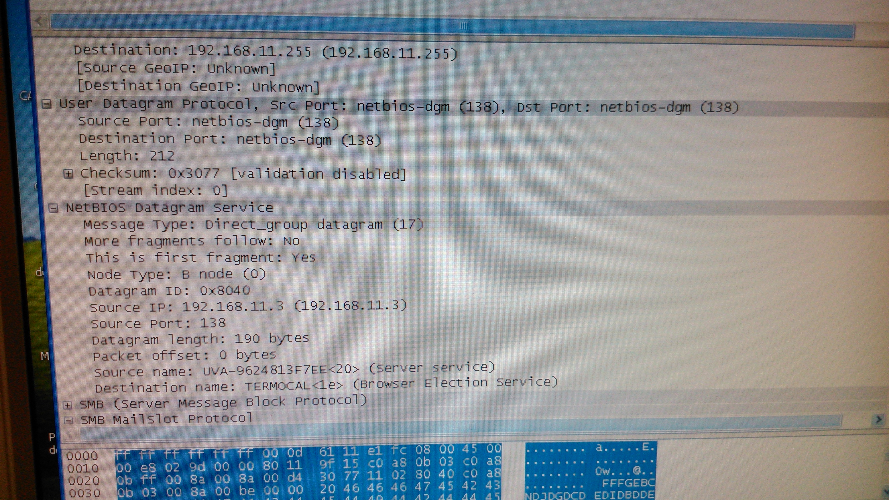

RE: Wiznet1000 not read data
by jim ·
In your image, the operation is normal. What is problem?
And please attach raw data of Wireshark, not image.
