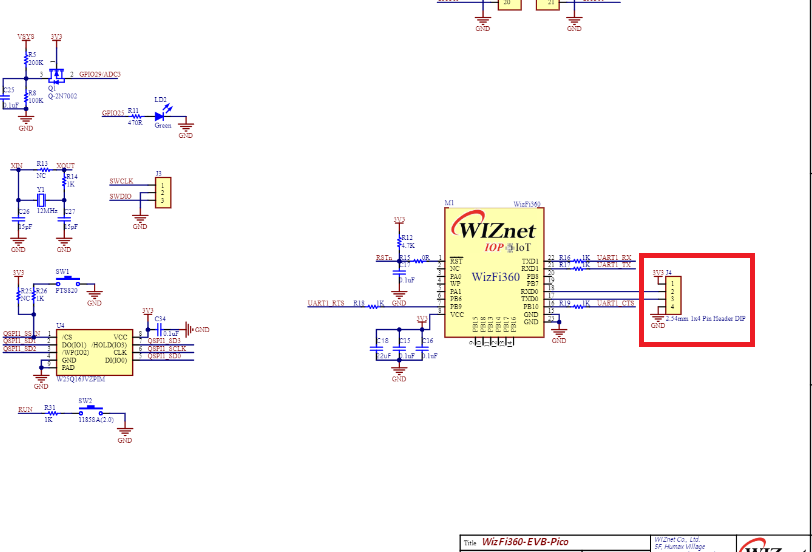

The F/W update of the WizFi360 built in the WizFi360-EVB-Pico can be done through J4(UART0).
https://docs.wiznet.io/assets/images/WizFi360-EVB-Pico_SCH_V100-1-44628336cfa4d71657c04fbf4bf9b8c4.png
