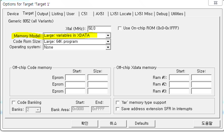

I wish you would change the Memory Model as “Large: variables in XDATA” in target tab of option.
And when you changed the mode, I want to know if the same issue occurs.
Could you please you send me your project if it is possible to send project?

memory model. While trying to diagnose this symptom I tried the
other two options to no avail.
