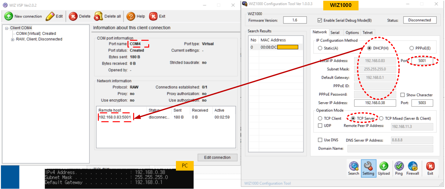

This figure shows the setting information of WIZVSP and WIZ1000

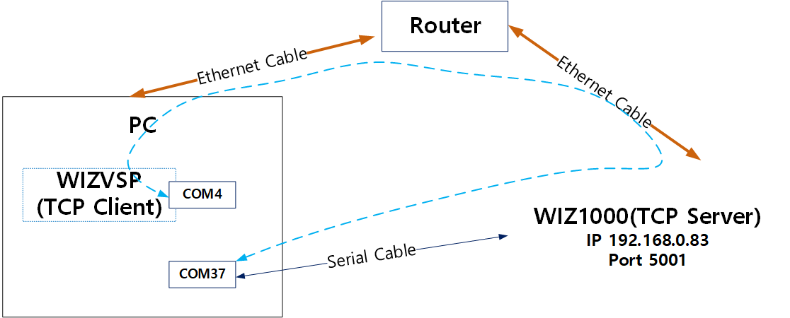

This figure shows my test setup.

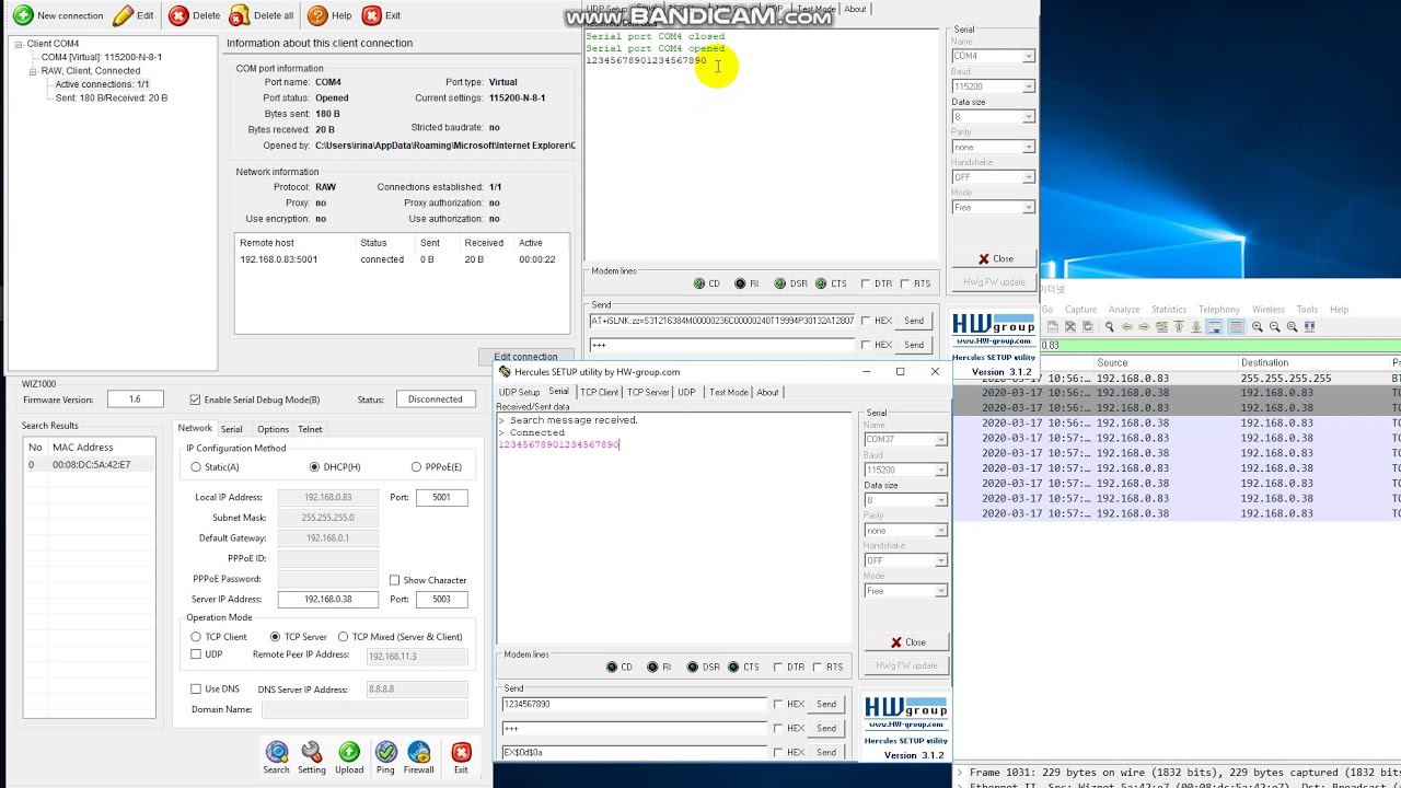

I took a video about WIZ1000 test and I think you can see it and follow it.
