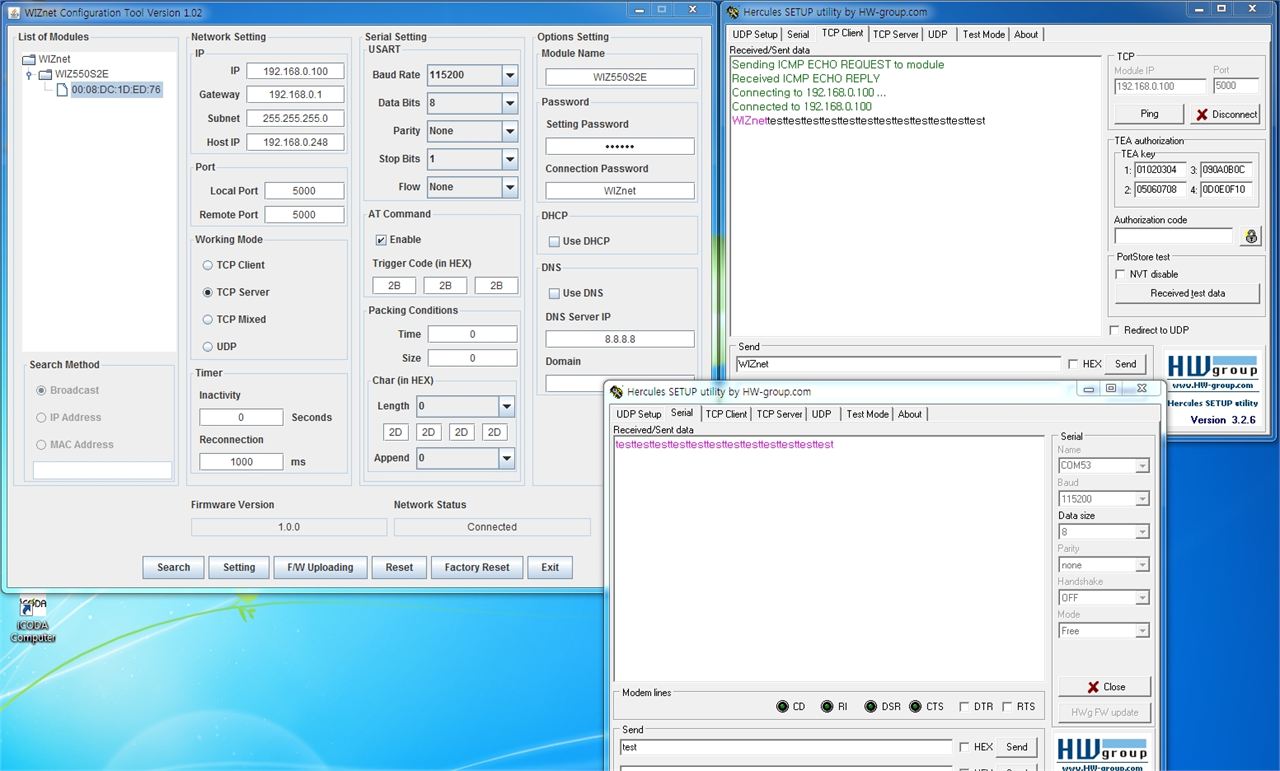

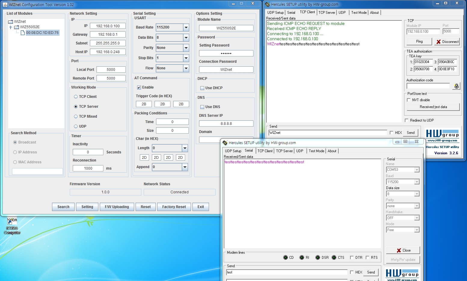

Wiznet550se2-232 not transmitting
RE: Wiznet550se2-232 not transmitting
by jim ·
Hi.
Please check the transfer of “Connection Password” to a target(TCP Server).
Refer to 1:05 position of UCC in YouTube (wizwiki.net/wiki/doku.php?id=pro … utorial_en)
And you can remove the Connection Password by Configuration tool if you not use this function.
