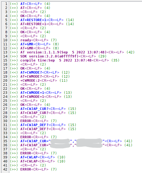

@austin thank you for the answer
Please tell me if the AT commands are entered correctly here?
I rewrote F/W before and after creating this post, but it didn’t solve the problem.

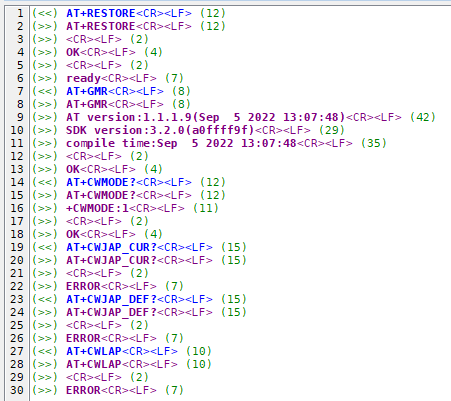

Hi @AndreyS
Could you try factory resetting to UART0 rather than UART1?
When factory resetting to UART0, it is ‘AT+RESTORE’, not ‘AT+RESTORE=1’.

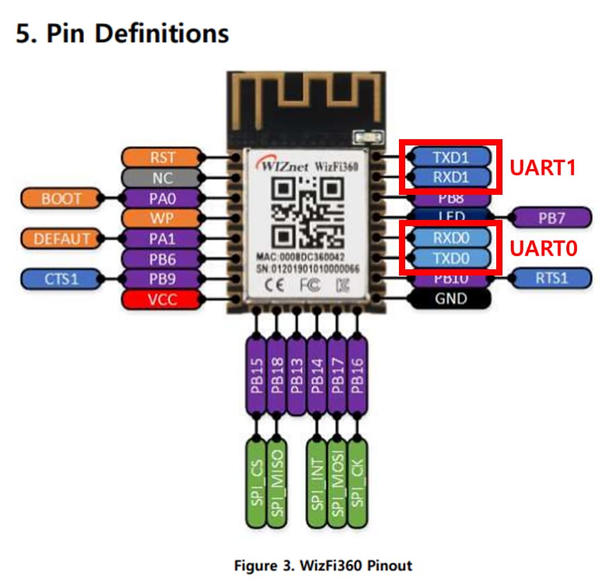

Hi @AndreyS
WizFi360 provides two UART ports.
UART1, which is typically used to enter AT commands, and UART0 for debugging, which is not used.
With UART0, you can enter some AT commands.
RE: "AT+CWJAP..." command stopped working
by AndreyS ·
@austin
OK
To UART0:
Then to UART1:

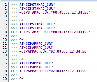

Hi @AndreyS
Could you check the MAC address?
by AndreyS ·
Hi @austin
Hi @AndreyS
I think the MAC address was deleted due to a previous mistake and the MAC address was changed to ‘0x:08:DC:12:34:56’, which is the default MAC address on the F/W.
So it seems that the problem is caused by the incorrect MAC address.
Since entering the MAC address is a matter that should not be leaked to the outside,
If you tell me your e-mail address, I will reply to you how to enter a new MAC address.
