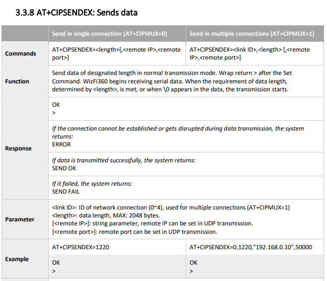

Is the command you used “AT+CIPSEND”?
how about use the “AT+CIPSENDEX” command?
you can send it immediately when you enter “\0”.
refer Wizfi360 atcommand document

Thank you very much for your answer.
Sending \0 would work for me.
However, is it possible to use AT+CIPSENDEX during transparent mode (AT+CIPMODE=1) ?

hello @FernandoPereira,
you mean, Is [UART - WiFi] what you need?
I’m sorry, but we can’t control the transmission time just by command or line termination characters.
Firmware needs to be modified to support configured latency time
I’m sorry I couldn’t help you.
I will try to apply it to the next update. ASAP
