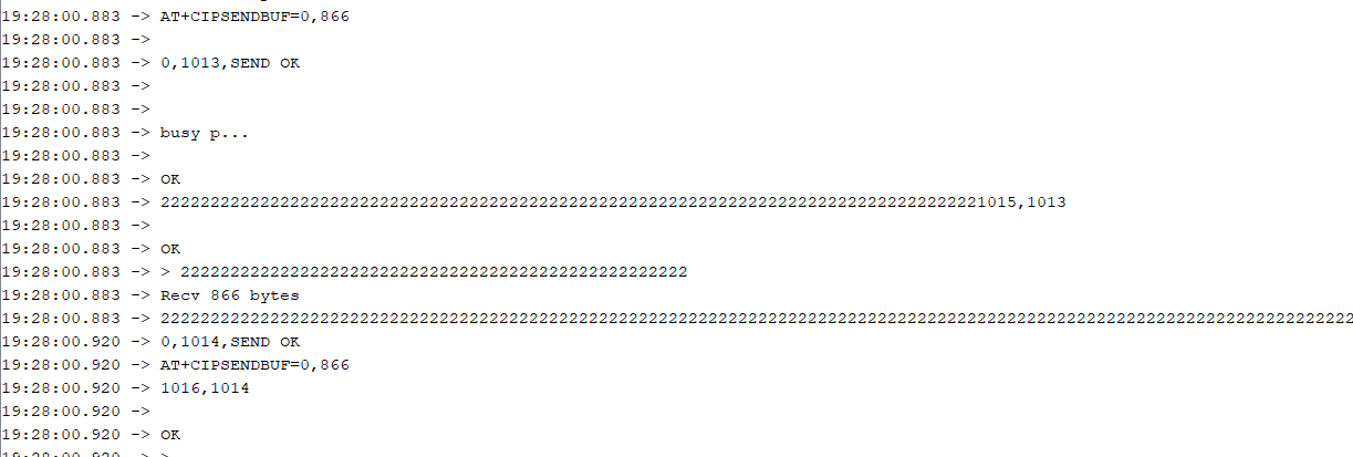

As the server mode does not support Transparent data transmission, i am using AT+CIPSENDBUF CMD for transmitting data into network(TCP Client will receive this data on other end)
Transmitting data in below sequence
Repeat 1, 2,3 steps upto 10 min continuously
When i am testing the above changes, observed busy p… and sometimes busy s… as shown below.
In below snippet, 22222222222…are the actual data that i am transmitting.
When busy p… is occurred, AT+CIPSENDBUF this CMD itself is transmitted to network (observed this CMD on TCP Client )

Hi @Padmini
I am sorry for late reply.
busy s… : Busy sending. Can’t respond to new input because it is sending previous input.
busy p… : Busy processing. Can’t respond to new input because it is processing previous input.
Next AT command must be entered after the response result of the AT command, such as ‘OK’ or ‘ERROR’.
When data transmission fails, ‘SEND FAIL’ message is output.
After sending data, when ‘SEND OK’ message is output, send next data.
