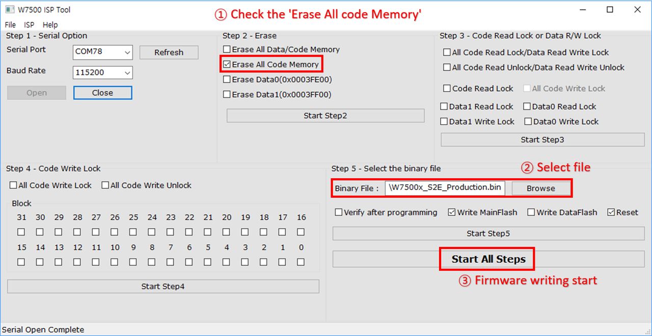

How to flash W7500P to be exactly equal to W7500P-S2E?
RE: How to flash W7500P to be exactly equal to W7500P-S2E?
by rena ·
Hi @polemon,
I think the reason is option you checked (Erase All Data/Code Memory) in the “Step 2 - Erase” part.
When this option is checked, it will erase all data including MAC address and write a new firmware.
If you want to update the previously used firmware, set as follows.
If the chip worked before, I think you have a MAC address. You have to input the MAC address to the device.
Please refer to the link below for setting options and how to insert the MAC address.
