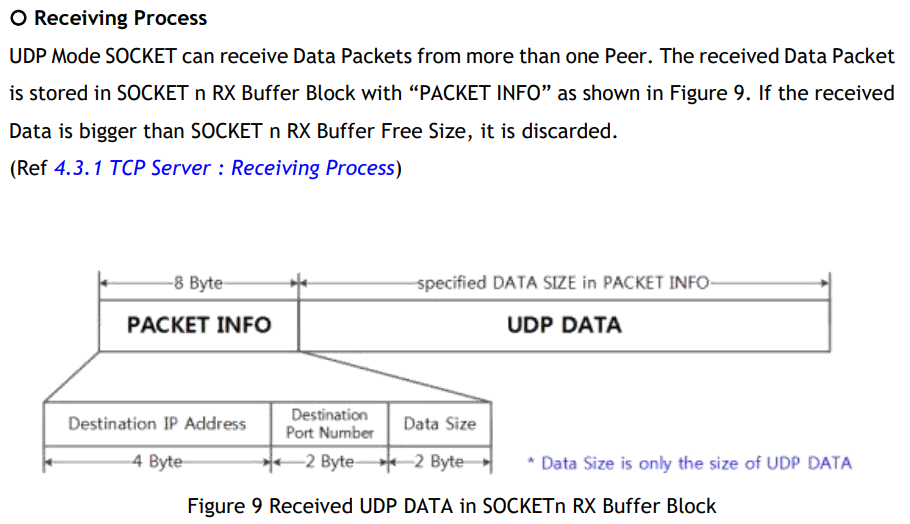

Tell me please.
How to read the sender’s MAC address from the Socket RX buffer register of the W5500 chip. Sn_MR_UDP mode of operation.
Is it realistic to do so.
RE: W5500 UDP sendto() timeout
page 68 of the W5100 manual.
