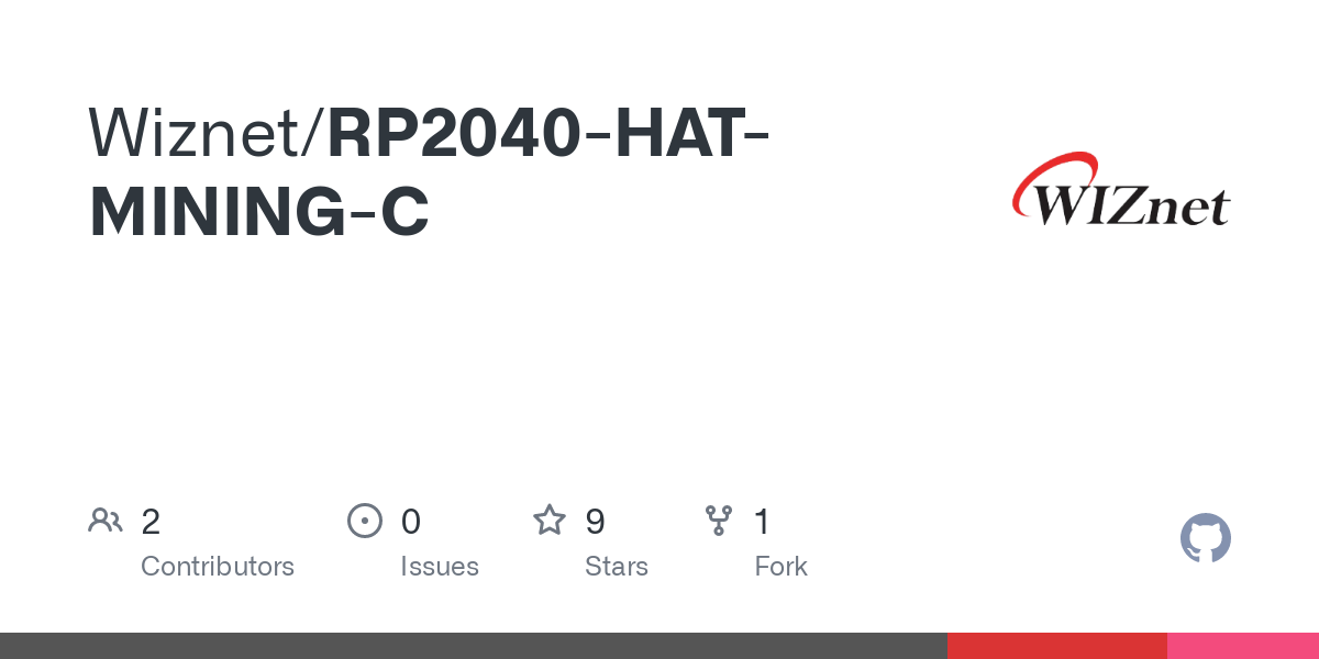

There is an example of using both core0 and core1 in W5100-EVB-Pico.
Please refer to adding lib, how to use functions, etc…
