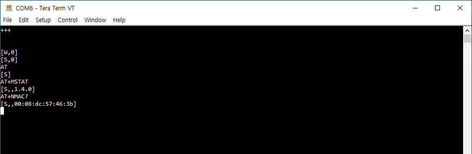

Hello @jcomfort,
Entering into command mode is possible even if the ethernet cable is not connected.
When entering ‘+++’, did you enter CR/LF(\r\n) after ‘+++’?
When entering ‘+++’, you do not need to enter CR/LF(\r\n) at the end.
I tested with ethernet cable removed in F/W v1.4.0. But there was no problem.
Please refer to the picture below as the test result.
