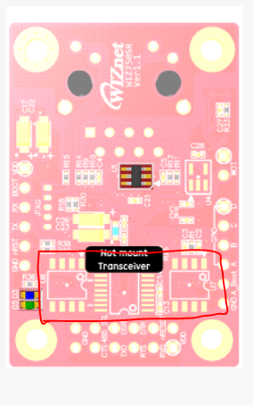

Second check point.
If you buy the WIZ750SR-TTL , your product doesn’t have any RS-232C & RS-422/485 Transceivers on it. If you look at the back of the product, you can see it.
