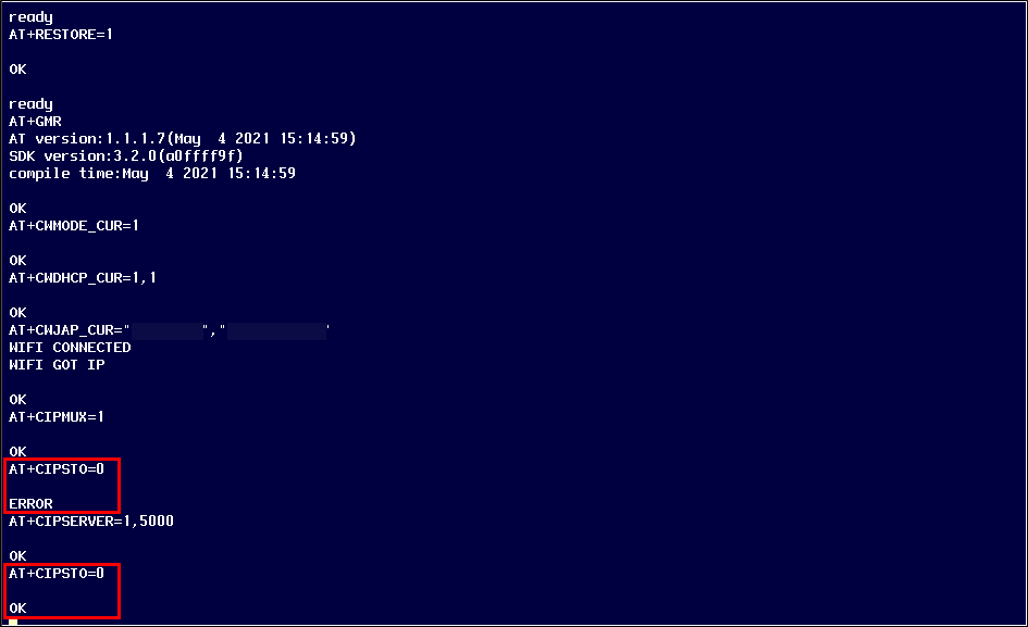

WizFi 360: Unable Sets the TCP Server Timeout
RE: WizFi 360: Unable Sets the TCP Server Timeout
After creating a TCP server, set the TCP server timeout.
And the latest F/W version of WizFi360 is v1.1.1.7, if you do not have to use v1.0.7.5, please use the latest F/W version v1.1.1.7.
