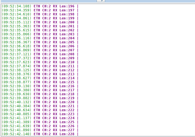

Problem:
The “RX Len:” is not length, it is just counting 0-255. Packet sequence for debug.

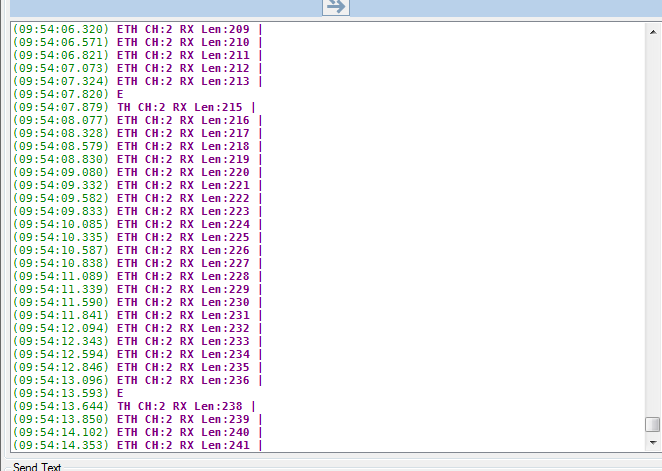

No problem with 1.6.4:
(Sorry for 2 commets, but Im new user, and pictures limited to 1 image/post)

The latest firmware has not been updated on the homepage and it is attached, so please use it.
WIZ140v1_7_0_210209.zip (25.4 KB)
