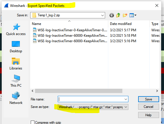

Could you please check the network packet using wireshark tool(freeware)?
I want to confirm your network status.
If the configuration tool is OK. you can see the configuration tool send the packet using wireshark.
Also if you upload the packet, I wiil check it. The file extension name of the captured packet will be .pcapng
