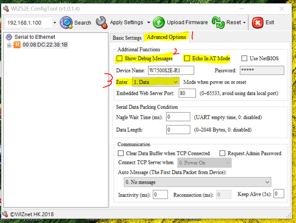

Hi, I’m Ron from WIZnet HK.
Thank you for your information.
About this issue, our configuration tools could solve your problem.
Please follow the following steps:
Search the module by configuration tools
Turn off “Show Debug Message” & “Echo in AT Mode”
Select Data Mode
Press “Apply Settings” (The module will auto reset)
Link for the latest configuration tools:
