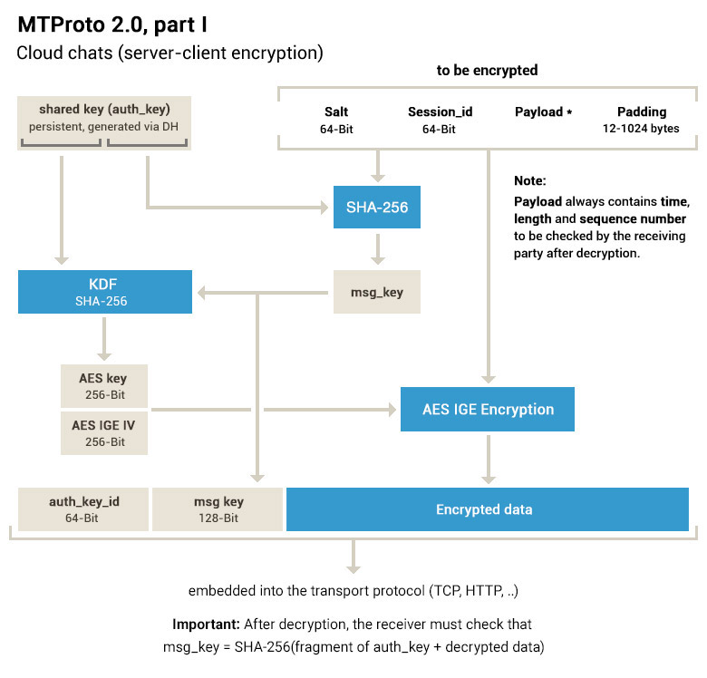

Here is some technichal information about Protocol: Detailed Description
As i know in module ESP8266 has already been realizaed SSL connection to Telegram service. There are many projects with it in Youtube .
