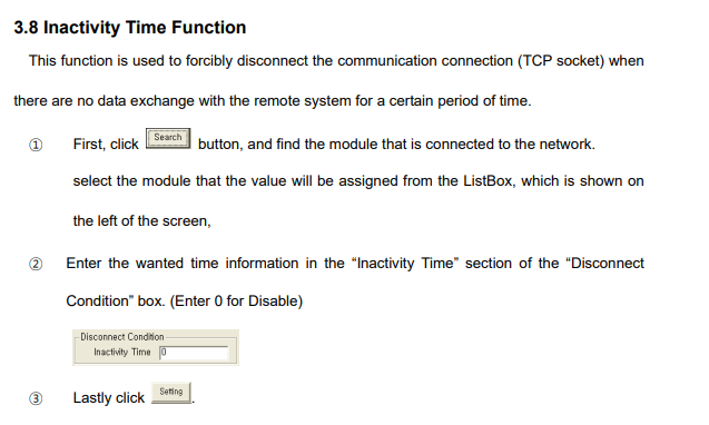

Unfortunately, there is no function such as error reporting. If the TCP connection is abnormally disconnected, it may not be possible to make a new connection because the previous connection is maintained. In this case, it can be improved through the inactivity time function.
