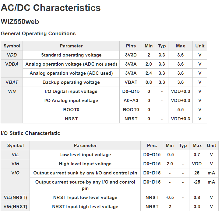

I think you want to need this information as below, is it right?
HW reference link : https://wizwiki.net/wiki/doku.php/products:wiz550web:wiz550webds_rev1.1_kr
Please let me know if there is not enough content for the information you want.

Thanks Irina – but no, you’ll notice there are no currents specified for VDD or VDDA, only voltages. Currents are shown for VIO, but not for the 3.3V supply pins.
Regards,
Andy

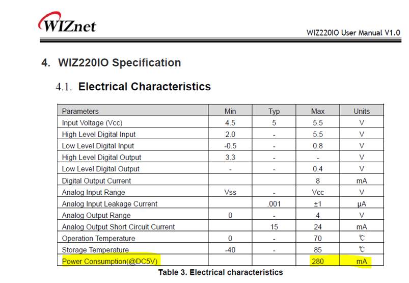

An example of what I’m looking for can be found in the WIZ220 user’s manual:

I used your reference link. This is really helpful for me.
