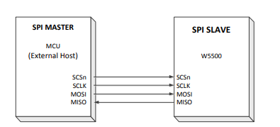

You can just connect to as below picture.
W5500 SPI Frame is refer to datasheet P.14
https://wizwiki.net/wiki/lib/exe/fetch.php/products:w5500:w5500_ds_v109e.pdf

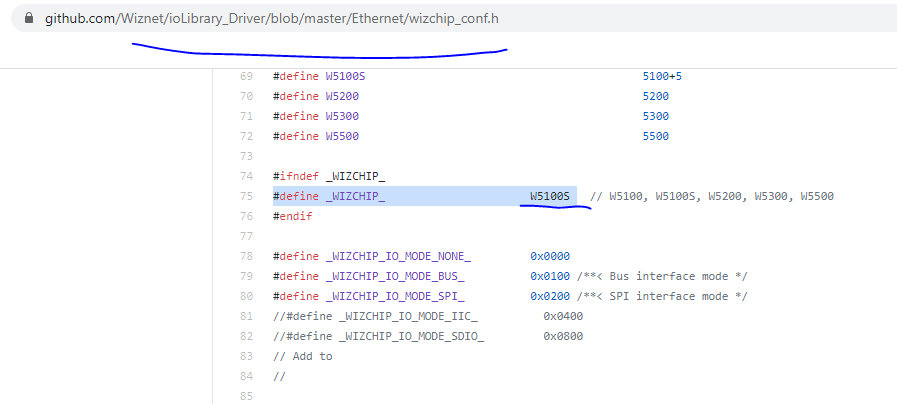

The ioLibrary means “Internet Offload Library” for WIZnet chip. It includes drivers and application protocols. The driver (ioLibrary) can be used for the application design of WIZnet TCP/IP chips as W5500, W5300, W5200, W5100 W5100S.
You need to modify the value of WIZCHIP in wizchip_conf.h
You can use the ioLibrary as W5500 .
ioLibrary Doxygen document Link: Refer to TODO in this document
