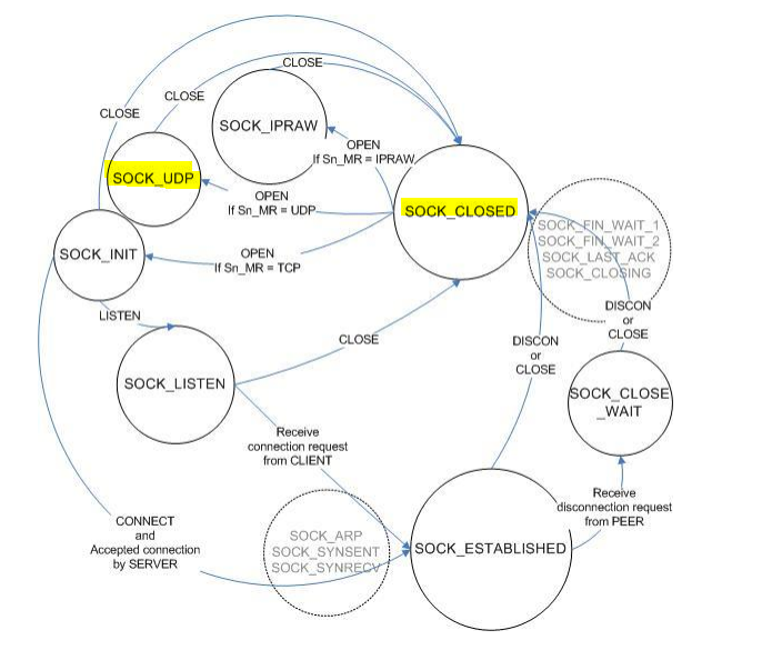

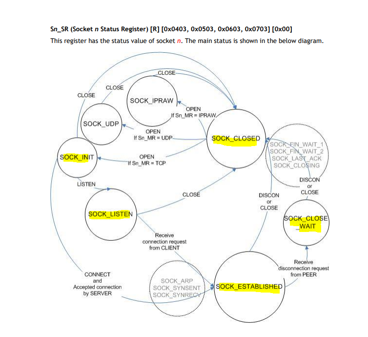

The status to be managed while using the tcp server is as follows.
This is because the rest of the status is a brief moment or does not occur on the TCP server.
Yes, when FIN is received, W5100 becomes SOCK_CLOSE_WAIT state.
Transmit DISCONNECT or CLOSE Command.
CLOSE is recommended for INIT and LISTEN, CLOSE or DISCONNECT for ESTABLISHED, and DISCONNECT for CLOSE_WAIT.
Like the tcp server, the status to be managed while using the udp is as follows.
Please send a close command

Is that possible I get these “brief moment” status when I read Sn_SR, or they are hide from users?
RE: sent RST after got FIN
That is possible.
