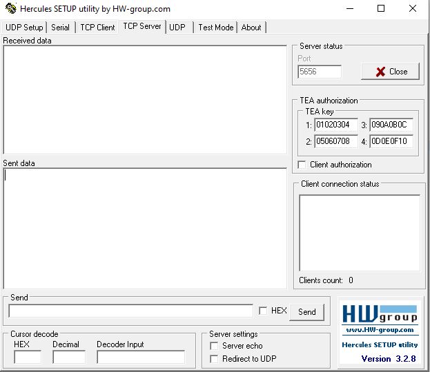

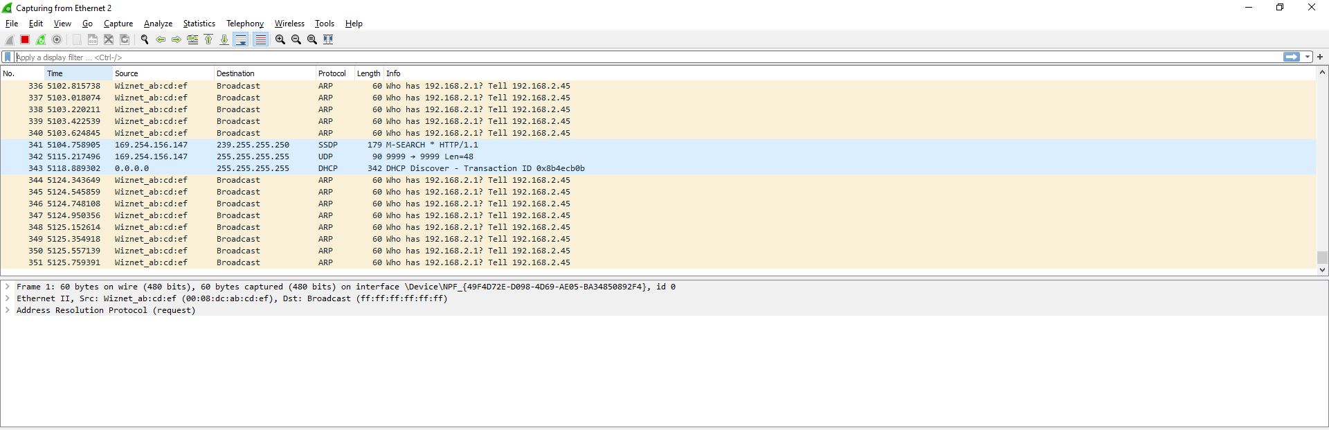

im using hercules and wireshark . this is the screenshots I see when I run the code .
İ used first time this apps . I think the connect function works according to the application. But I can not understand why I could not establish a connection with the server in the other application.
